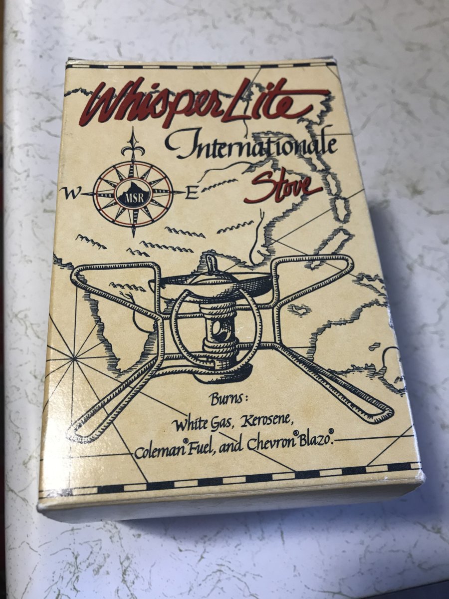

  7. Doc Mark
    19,650
    Greetings, @Primus 96 ,
    Yes, indeed. The V1 of the Whisperlite Internationale (note the "e" on the end, which was later dropped!) was marketed as a true Multifuel stove, with kerosene listed as a proper fuel for that stove. That's why we bought it in the first place! Please note that there was NO internet, back when we bought our V1 WPL, and everything we were told came from either catalogs, reviews in Backpacker Magazine, or better yet, from the knowledgeable staff at the backpacking stores from whom we bought our gear!! We had first tried the Optimus 00, but back then I had no idea what I was doing, and ignorantly bought Mautz Firepaste to prime it. That stuff was worthless, and did not allow us to fire the 00 easily as does liquid Meths!! Had there been a CCS, back then, we would have known better, and would have happily used our 00 for our entire trip! Tried the X-GK, too, but whilst it would prime, and run on kerosene, quite happily, it was FAR too sooty and messy for our tastes. Again, had we primed with Meths, we'd have been just fine, but we did not know about that, at that time. So, we tried the WPL Internationale, V1, as it was touted as both priming and running fine on kerosene, and as we'd bought about 40 gallons of Water White, K1 kerosene for our trip (you could legally send kerosene in the US Mail, back then), we wanted to keep using that fuel.
    Here are some photos of the original box from our V1 Internationale, which shows how that stove was (incorrectly) marketed back then:
    You can easily see that "kerosene" is listed as a proper fuel for this stove. As I wrote in the beginning of this thread, however, MSR tech, Mike Ridout, later admitted that they never intended for that stove to be used with kerosene on a steady basis, despite their advertisements to the contrary!! I hope that clears it up for you, but if you have further questions, please let me know. Take care, and God Bless!
    PS - As I've written before, there is NO need to buy a used V1 Internationale, when the V2 version is so very good, and very reliable with kerosene!! Buying a V1 is a total waste of money, period!

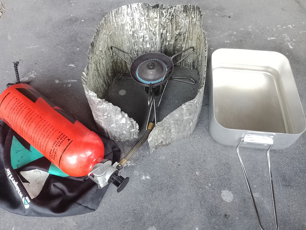

    Hi Doc,
    Thanks for all the advice I have gleaned from your posts over the years.
    Last year I bought a used Whisperlite International. It only came with the stove, black and grey pump, a basic maintenance kit and the manual, which has the same artwork on it as the front of the box you show in the above photo. While it has a braided metal fuel line, I've always suspected it was a first version stove with an upgraded fuel line. I asked MSR in an email, but got no response. Does my assessment sounds about right to you?
  12. Doc Mark
    19,650
    Howdy, Kyle (@Kyle Raines ),
    Thanks for the kind words! As to your questions, of course, it's hard to be sure. But, a few things to consider. Back when MSR was actually doing conversions, and V2 Whisperlite Internationale had not been designed yet. Regarding the black and grew pump, I don't put too much stock in what pump came with what used stove, unless there is some sort of hard documentation, i.e., MSR instructions which shows that pump. My personal viewpoint is that MSR would not have upgraded a V1 WPLI stove, as they usually would just send a new stove, for a nominal fee. The ONLY stove that MSR upgraded to the newer braided brass fuel line, was my first MSR FireFly. Mike Ridout, who was the head stove tech at MSR back then, did it for me, as a favor. Also, since the generator loop on the V2 is much larger, it would not fit in the actual burner of the V1.
    So, to wrap it all up, I'm guessing you have a actual V2 stove on which some parts "may" have been mixed and matched (the pump). Or, you have an early V2. Have you burned kerosene it it often? How did it work for you? How about some photos, please? Talk later, and God Bless!

    @Doc Mark
    I have burned kerosene and unleaded in it. Once primed it worked well with both, but I must admit, as much as I would like to be using it on the side of a mountain somewhere, this was only in my garage.
    I found unleaded to be horrendously stinky, but I'm in Canada and according to Coleman, Canadian auto fuel has too many additives to work well in Multi fuel stoves, which might account for the smell.
    I'm quite the wannabe backpacker. I've always wanted to be into backpacking, but either family or health has always kept me at just a dayhiker.
    I'll try to get some photos of the Whisperlite and post them in the next few days.

    @Doc Mark
    Here are some photos as requested. As you can see I purchased a new pump after acquiring the stove. The manual does appear to be for the first version you described at the beginning of this thread, looking at the fuel line depicted. I don't know if the original owner got a replacement stove, or if they were just using up old manuals. Either way, it's a good stove.
    I'm currently waiting on a Mini Trangia that is soon to join my collection. I already have 8 camp stoves as it is. But they all have their benefit and I can never pick a favorite. I think the Trangia will work well for dayhikes as I already do exactly as suggested by @Ed Winskill even though my wife thinks I'm crazy
  16. Doc Mark
    19,650
    Hi, Kyle, (@Kyle Raines ),
    Well, those instructions do look to be from the first version of the WPLI. I guess, if the former owner did send it back to MSR, right before the V2 model came out, they "might" have put the new parts on your stove. Either way, for all practical purposes, yours is now a V2 model. I know that "back in the day", MSR did offer a replacement fuel hose for the regular Whisperlite, as I have one of those, still NIB. But, I never saw one for the WPLI V1. I may have to disassemble my V1, and one of my V2 models, and see if the old and new parts interchange. However, I'm so far behind in doing things already in the que, that I'm not eager to add another fetting job. It should be easy, though, so who knows? If I do decide to go ahead with that experiment, I'll post the photos and results here.
    Good job in getting a new pump, Kyle! Very well done, and now you can use your stove, confident that it will work wonderfully for you. Just be sure to remember to lube the o-rings when assembling it for use. Thanks for the photos and God Bless!
