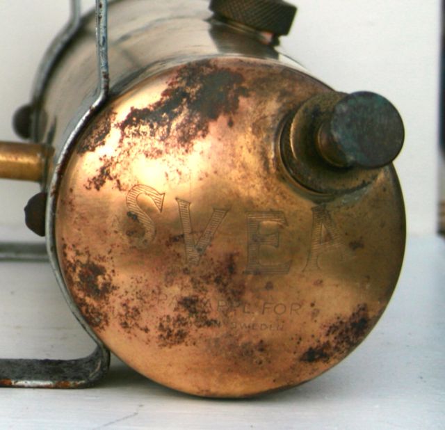

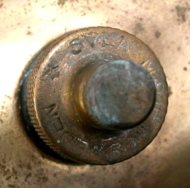

    I have just got this SVEA going for a friend. It look like a SVEA 153, but has a Patria regulating, self-cleaning, silent burner fitted.
    As this stove is being used "in the field" I have only cleaned it up, removed the verdigris, and thoroughly fettled it.
    "SVEA Made in Sweden":
    "SVEA Patent Appl. Made in Sweden"

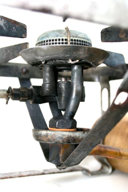

    "Patria" silent burner, made in Portugal:

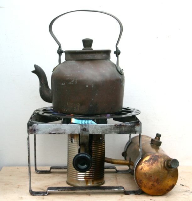

    The "tea-test":
    Hand-held... but you get the idea:

    With this burner, the top of the burner cap sits a bit high on the stove, so I suspect it is an after-market addition after the original burner failed.

    It is interesting but my belief is the 153 and 155 models have the tank on the right side. this is despite I feel the cardboard box image in other posts appearing to show the tank on the left. :?: If your friend's stove was originally a regulated burner then it would seem 155 is correct but in this case it could be difficult to know if it was, as you say fitted later so maybe it was a 153 originally. The support brace is interesting as it does not seem to be on all stoves as a 155 in another post has none. Is there a hole on the brace on the front side, same side as the pump and if so is this where an original regulator control stuck out through it for support? A penny for your thoughts!
    Iain Sedgman

    Iain,
    You can see in the first and 7th pics a hole in the brace: that is where a regulator control rod may have been fitted, but I haven't tried to set this stove up that way because I wanted everything tight for a person not used to fettling stoves.
    The tank pump is on the right hand side.
    I suspect the "Patria" burner is from a marine stove, but I could be wrong.

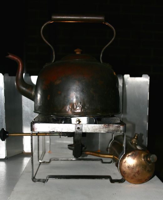

    Given the discussion about the Model Numbers for this series of SVEA stoves, here it is configured as a SVEA No.155; but with the "Patria" regulated, self-cleaning, silent burner, and the regulating handle fitted through the hole in the frame:
    Note that I've added a bit of height to the trivet by using a bicycle disc brake.

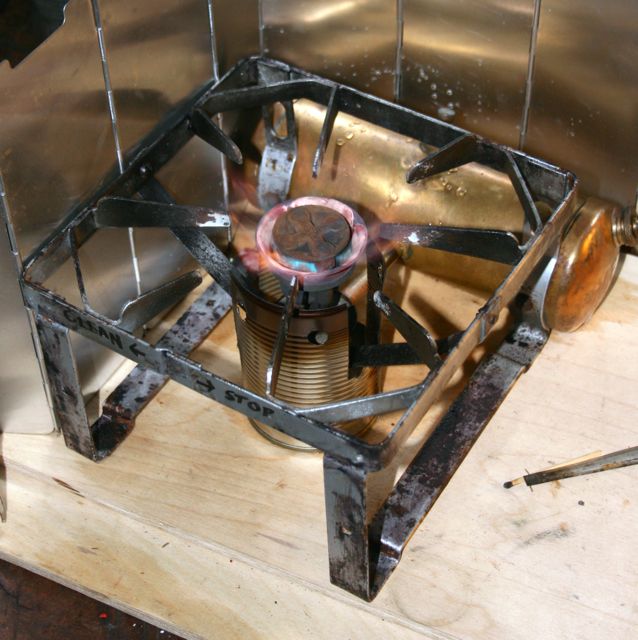

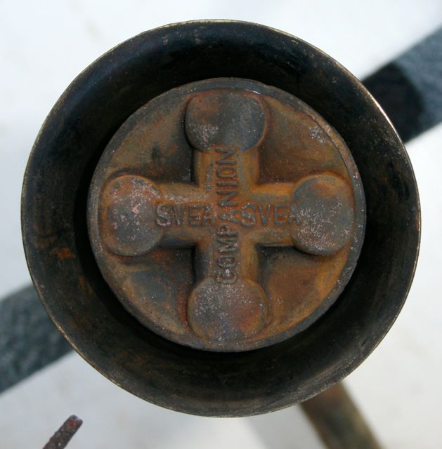

    And here it is before final cleaning, and set up with a standard "SVEA/Companion" roarer burner. As this stove is going to be used for bush work, this is the least complicated way to set it up (fewer things to go wrong; easier to maintain in the field:
    Hand-held in the dark:

    As the example above has "Patent Appl. For" on the tank, rather than a stamped model number (as seen in the Reference Gallery), does that help broadly date this stove?
