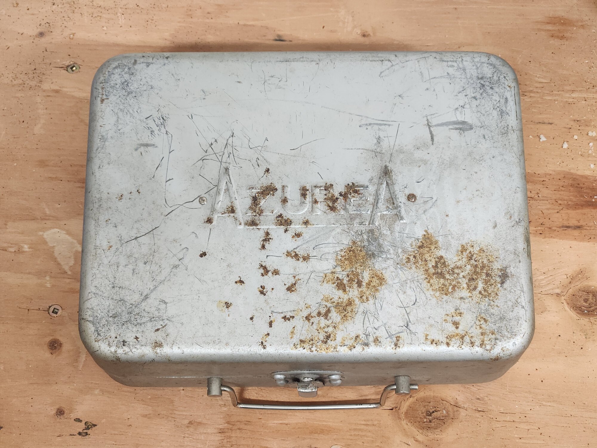

    I bought this stove November 2025 and it has been a project I have slowly chipped away at since then. I believe it was made in the 1930s.
    It has some rust on the painted steel case when I first received it. 20251128_101324.jpg

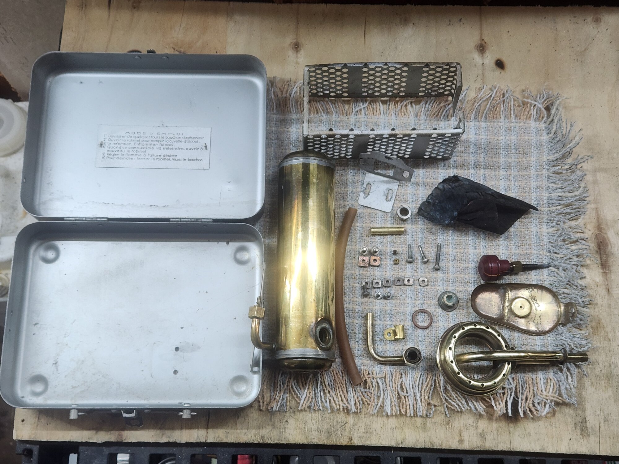

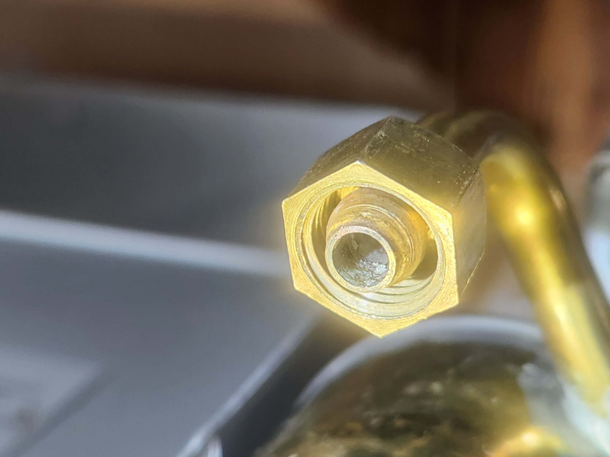

    Inside looked okay. The wooden control knob was cracked, some parts a bit bent. I found out the hose leaked, and I could tell it would not be a simple fix. Here it is with the original hose.

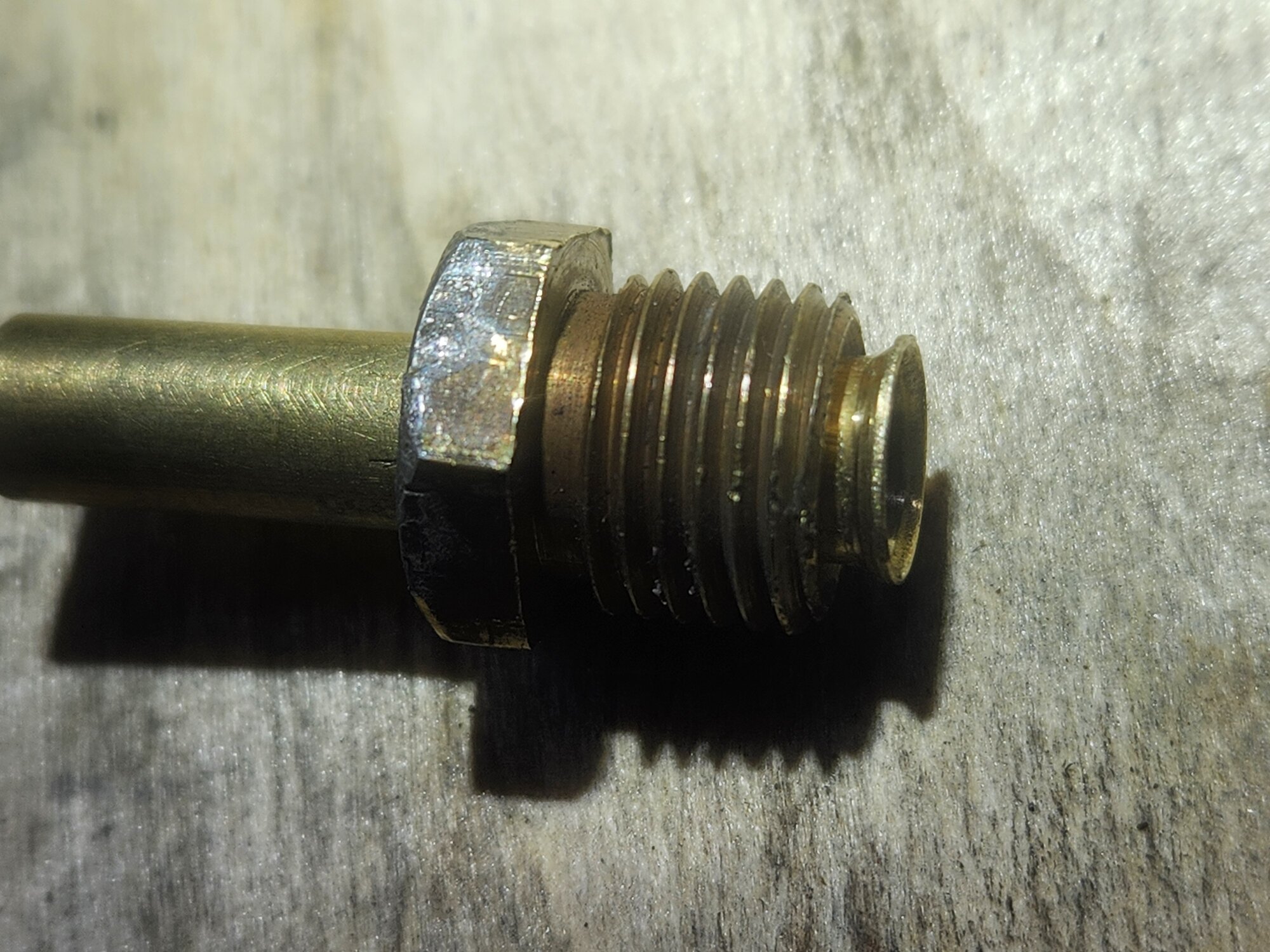

    I could not find any fittings to match the threads on the tank connection, so I flared one end of a brass tube to make a hose stem that could fit through the original bushing. 20260414_065328.jpg

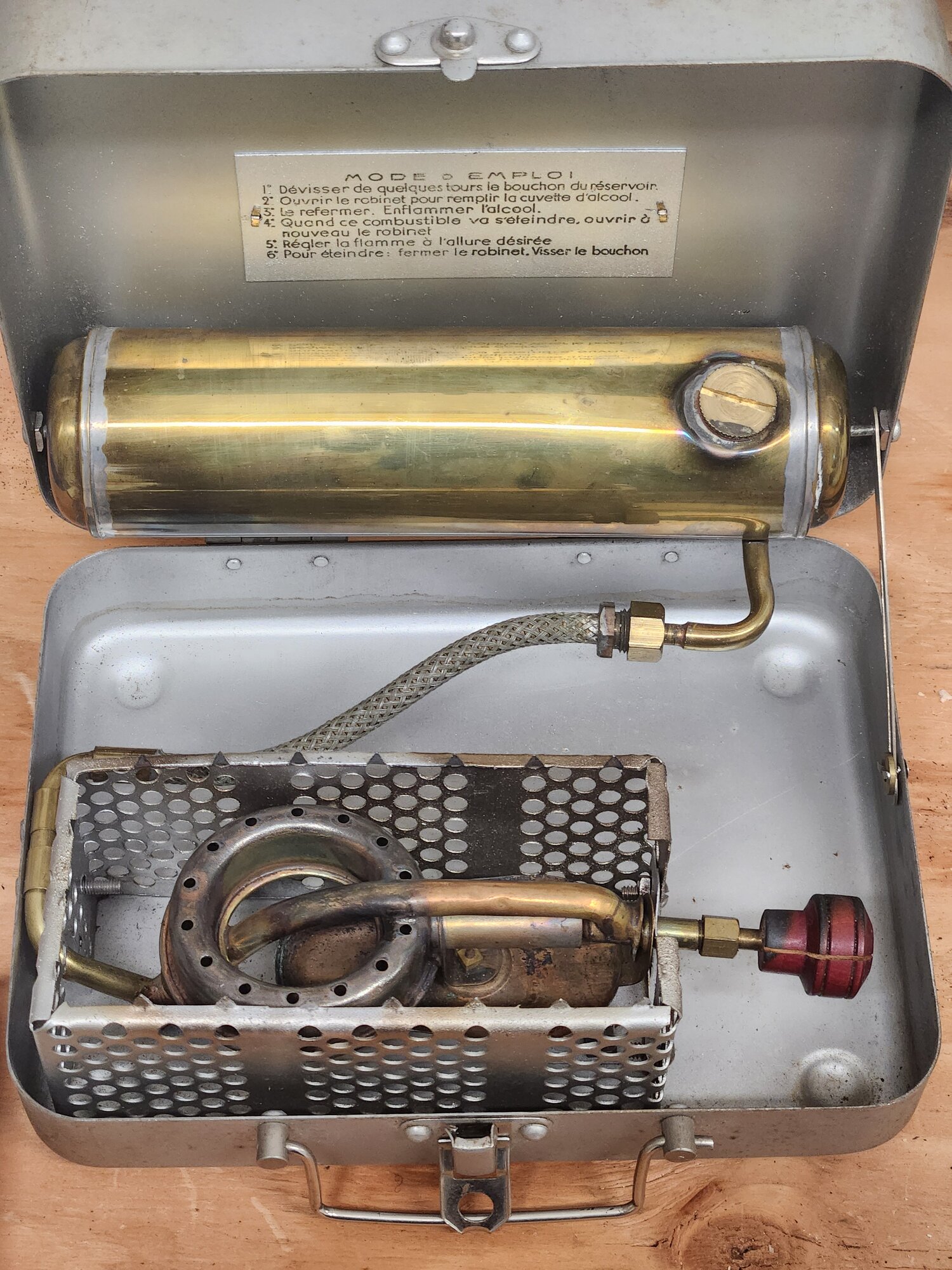

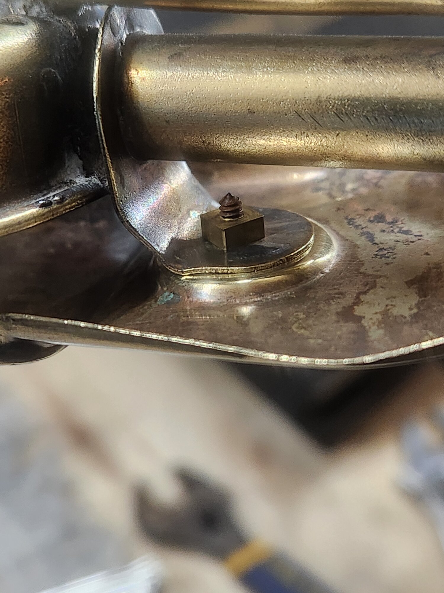

    Here is the stove disassembled. The hose pictured is not what I ended up using. The placement of some of the fasteners is very awkward. I reassembled this stove the day after reassembling an Enders 9061 D, and I can honestly say this was more difficult. 20260414_064913.jpg
    Connecting the priming cup to the burner was particularly annoying

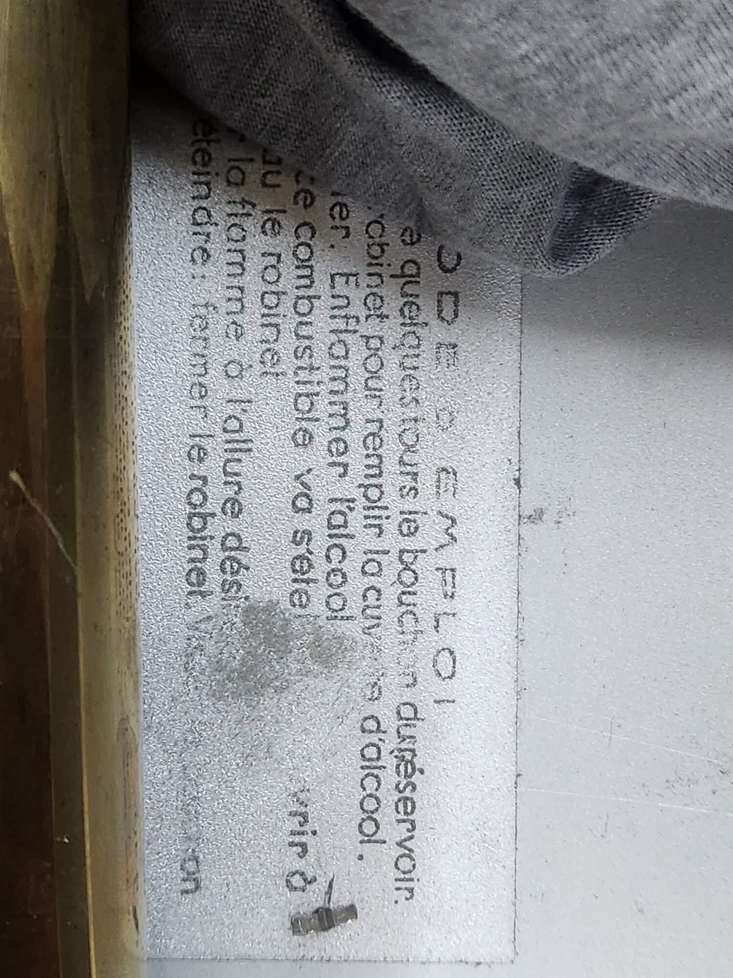

    While trying to get the tank installed, a small amount of alcohol dripped onto the instruction plate inside the lid. I shouldn't have touched it. I tried to gently wipe it away and the paint came with it. Devastating. I confirmed on that day I shouldn't work on stoves early in the morning.

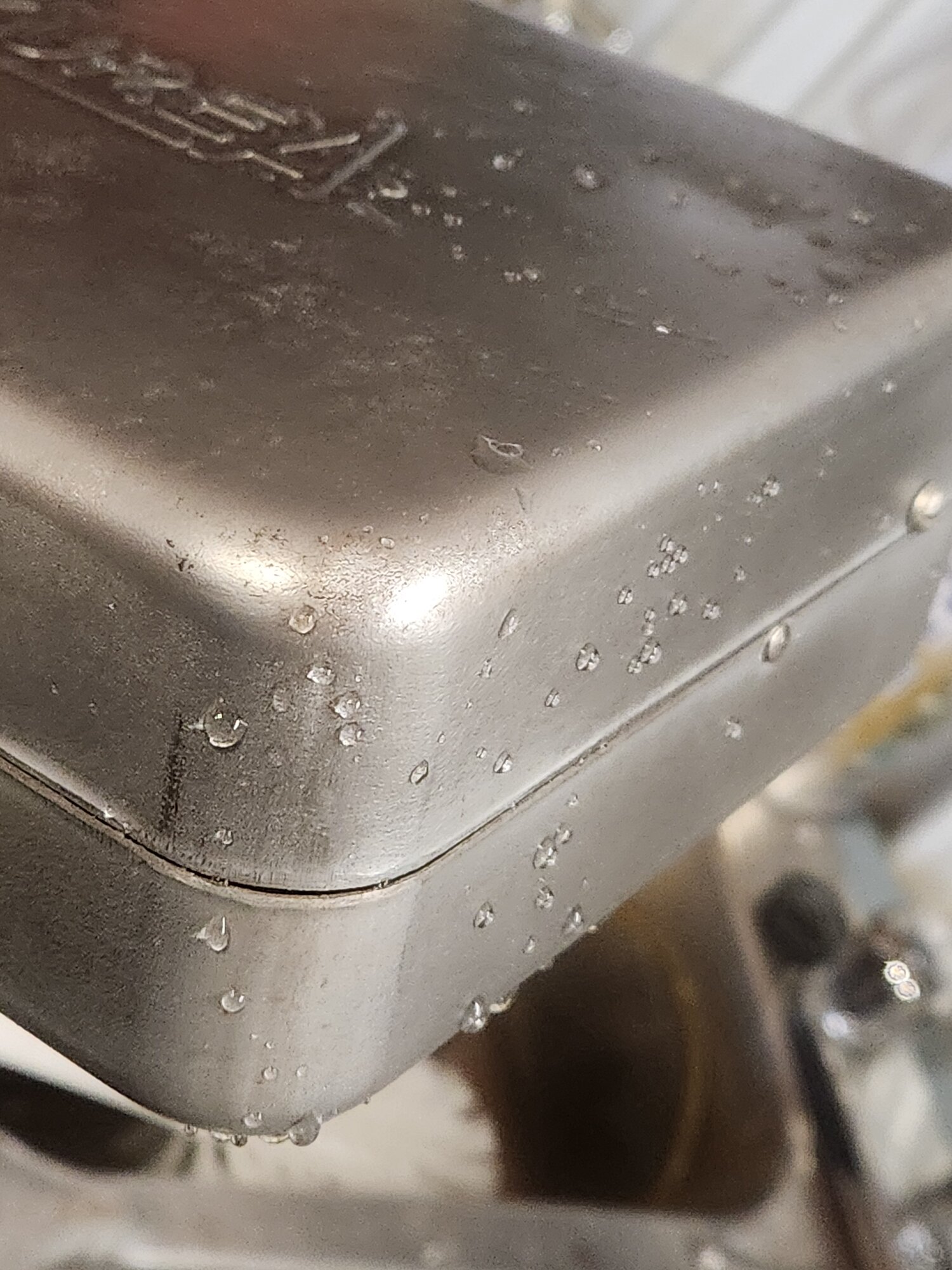

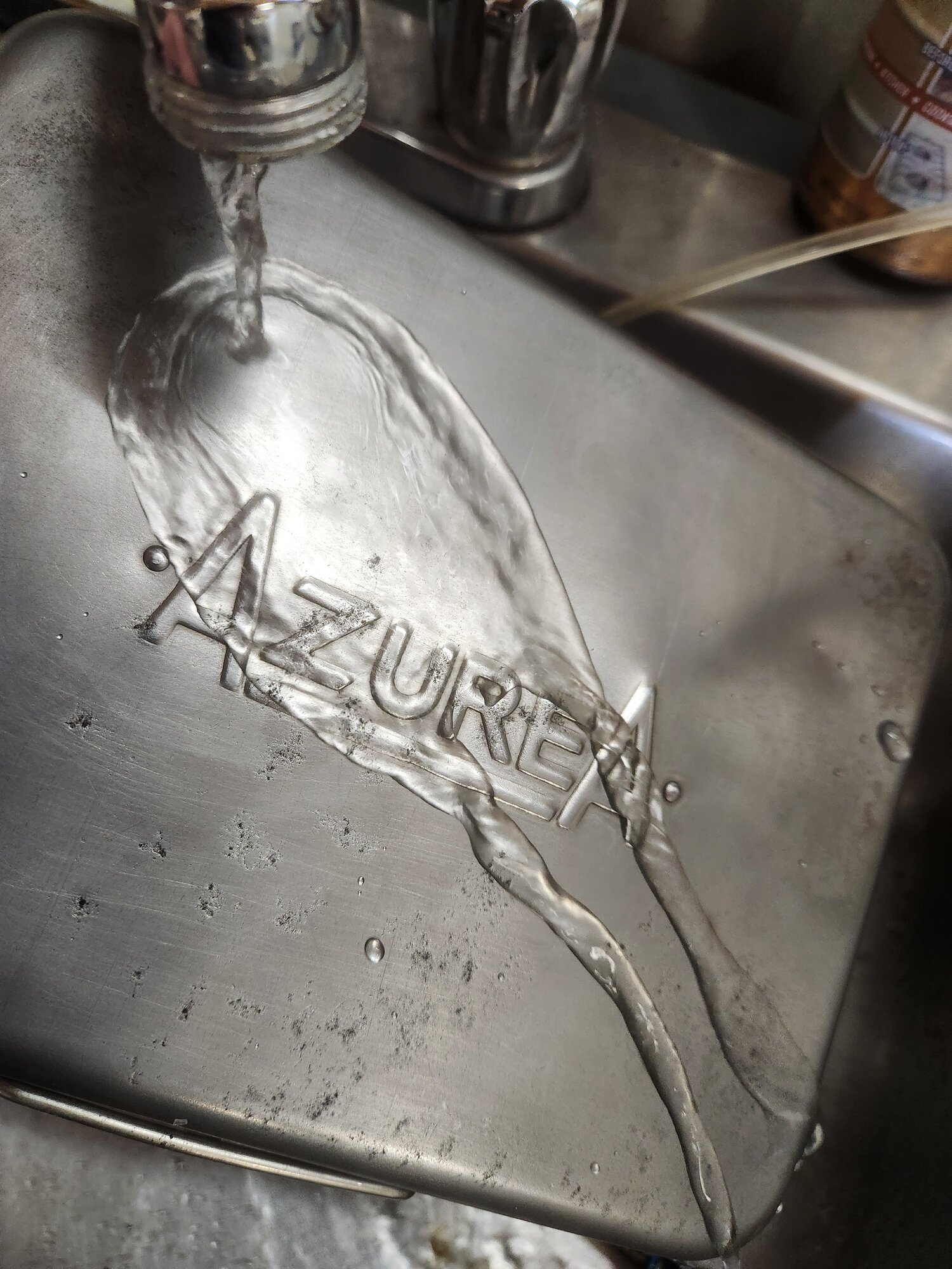

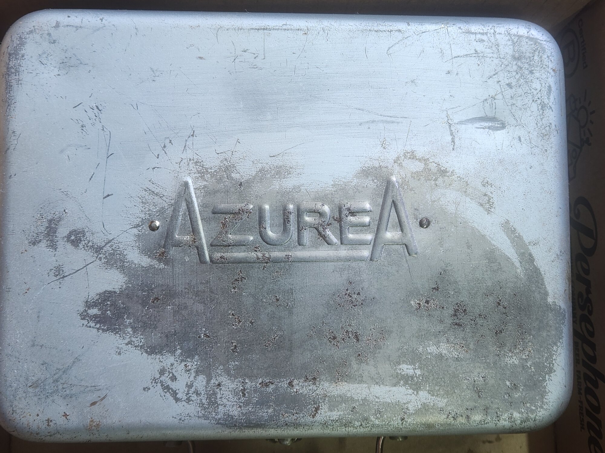

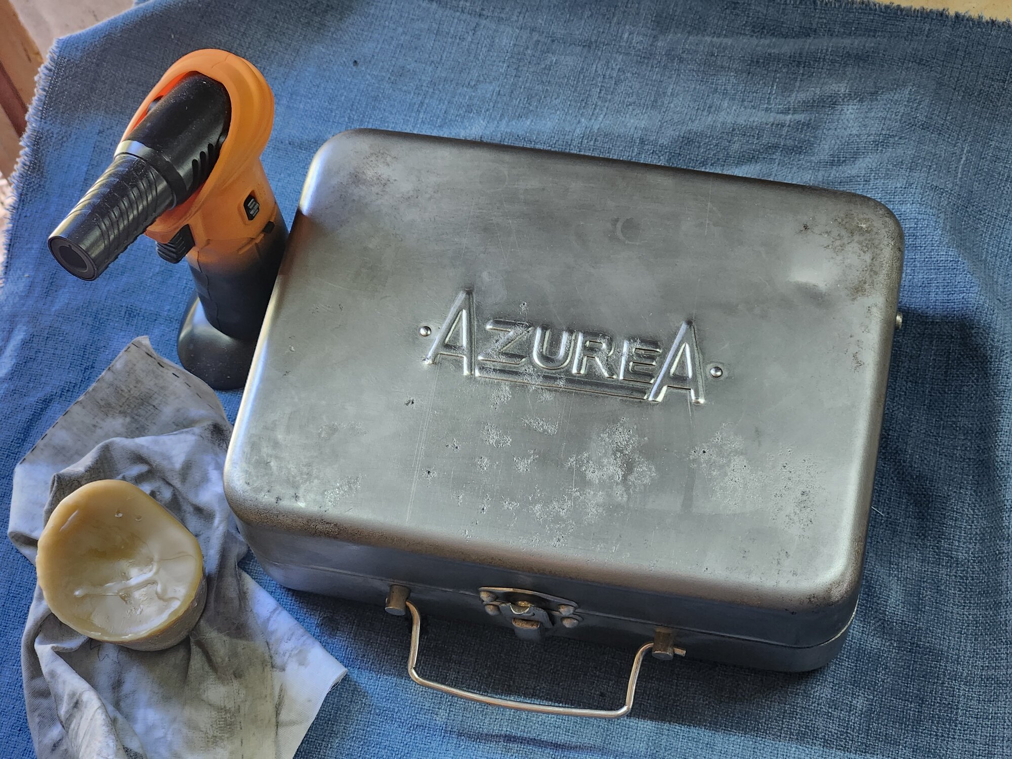

    Speaking of paint, I attempted to remove the outer rust without removing the paint. I got rid of the rust, but of course the paint came with it. I decided to strip all the paint from the outside, leaving the inside paint untouched to avoid damaging the instruction plate (this was before the fuel spill...)

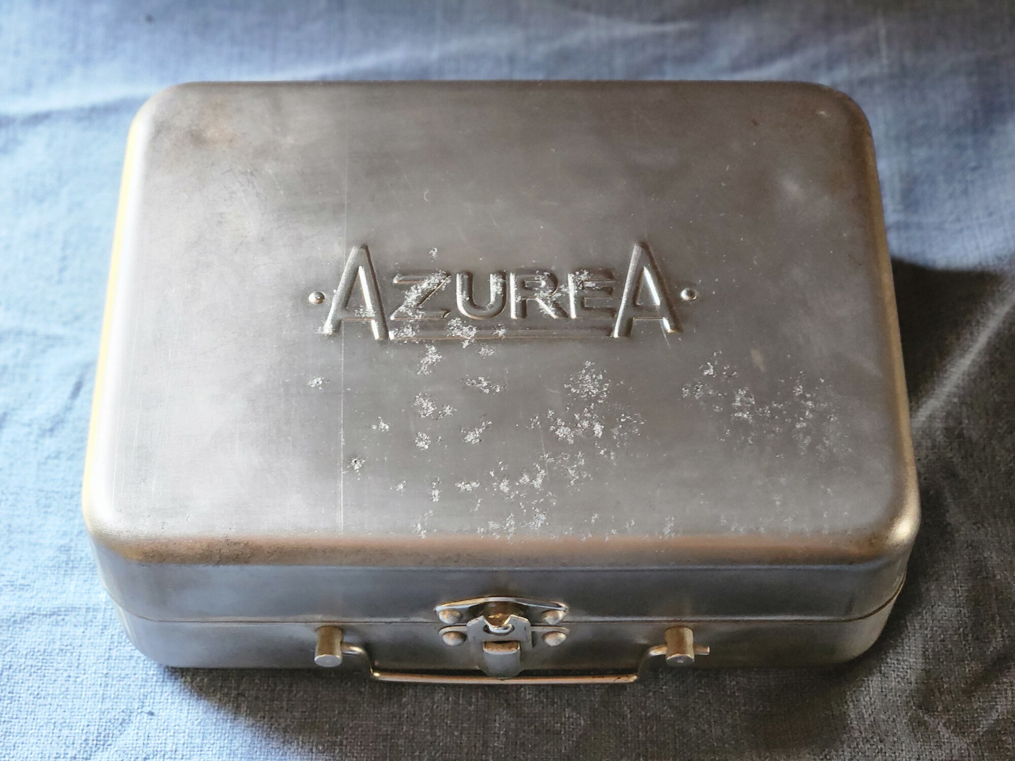

    I liked the look of the bare steel better than the Grey metallic paint, so I decided to shine it up, then coat with beeswax to protect it.
    Some scars from the rust

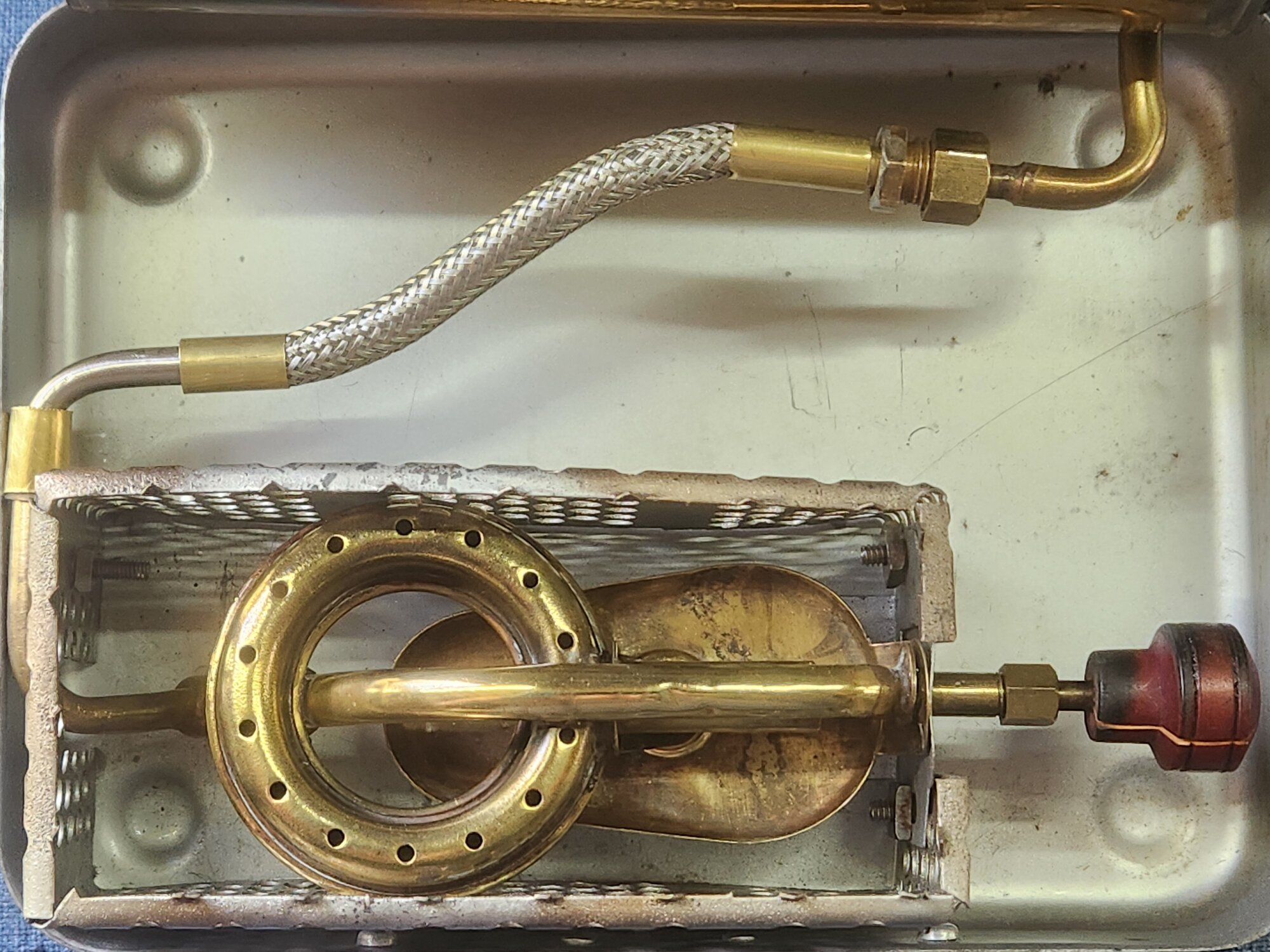

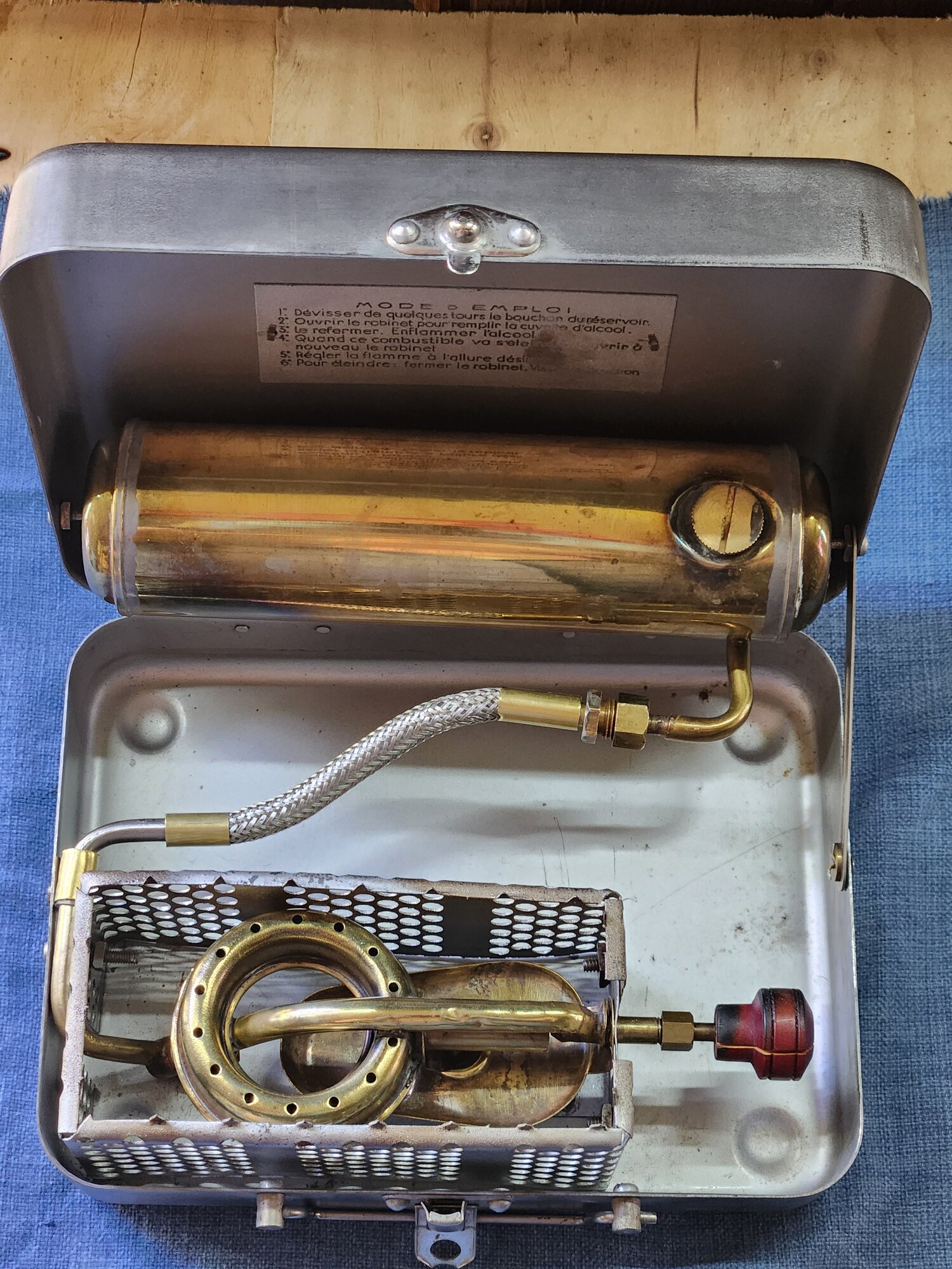

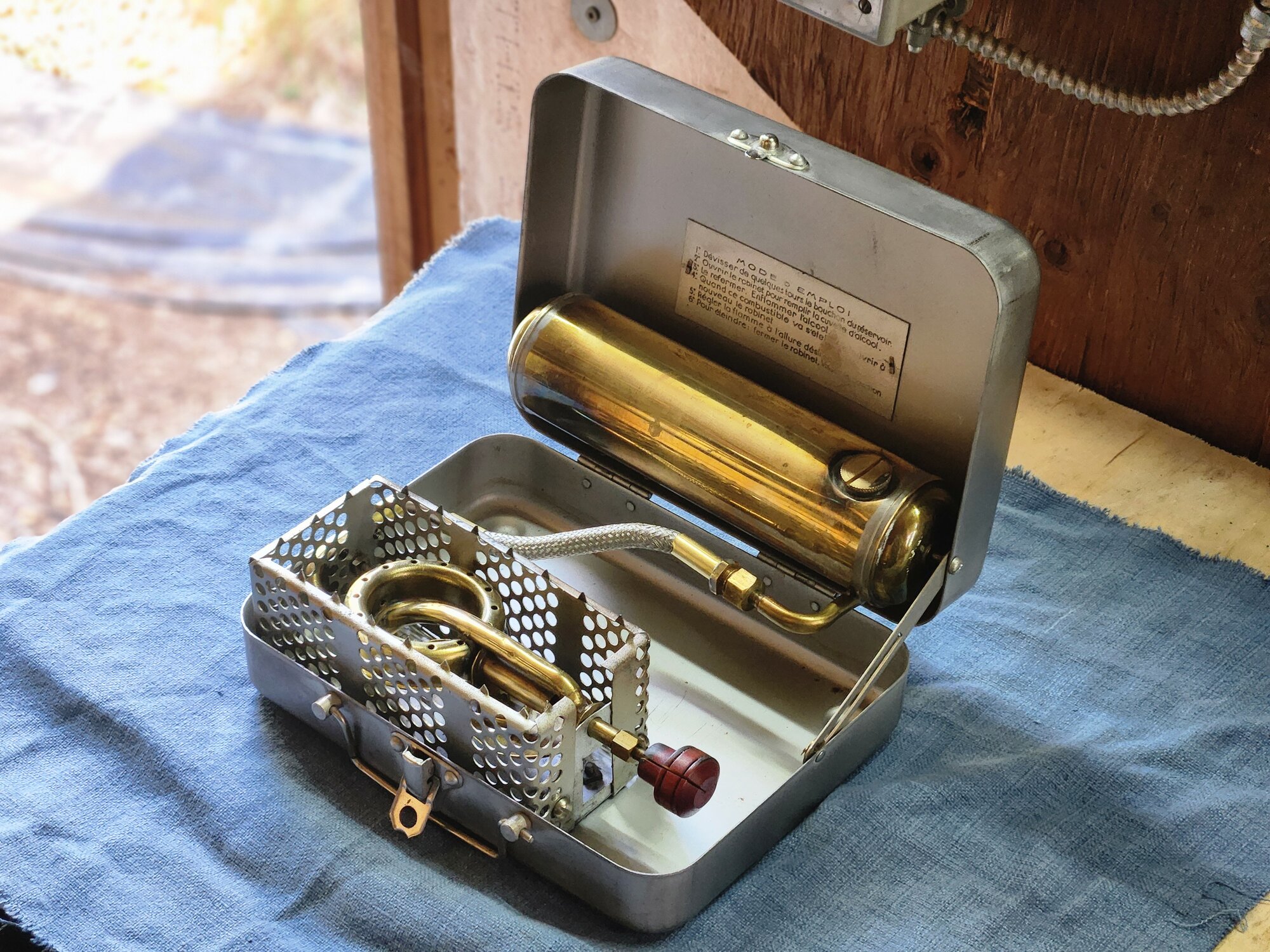

    I replaced the hose with silicone tubing, then wrapped the tubing with some stainless steel braid I cut off an old washing machine supply hose. I cut some brass tubing to slide over and act as hose clamps. The metal braid is completely unnecessary as the tubing holds no pressure, but I wanted to try to match the original look somewhat.

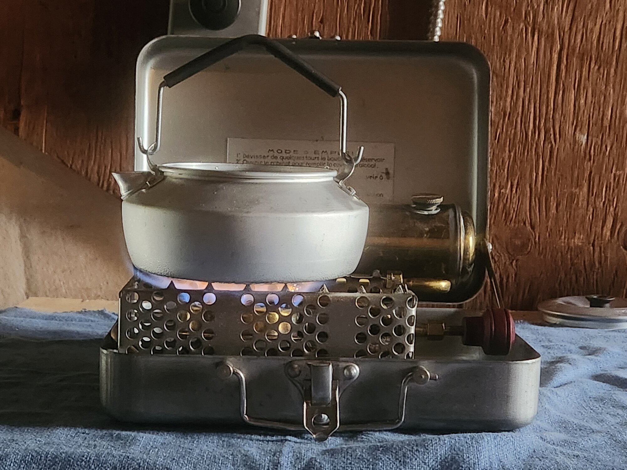

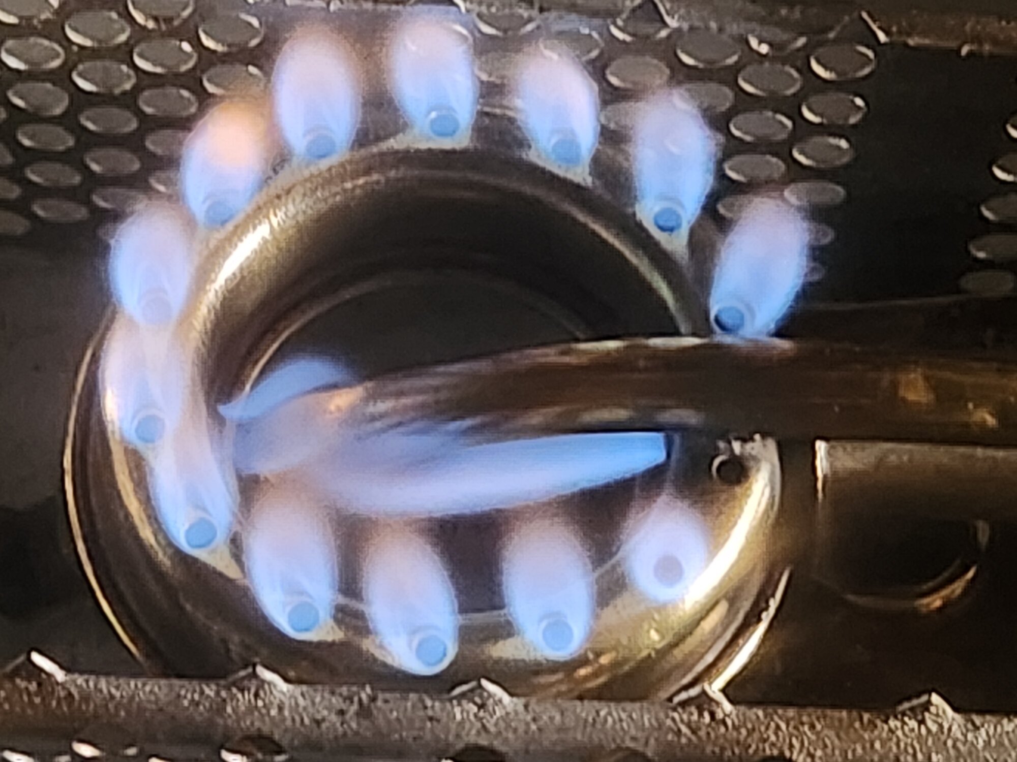

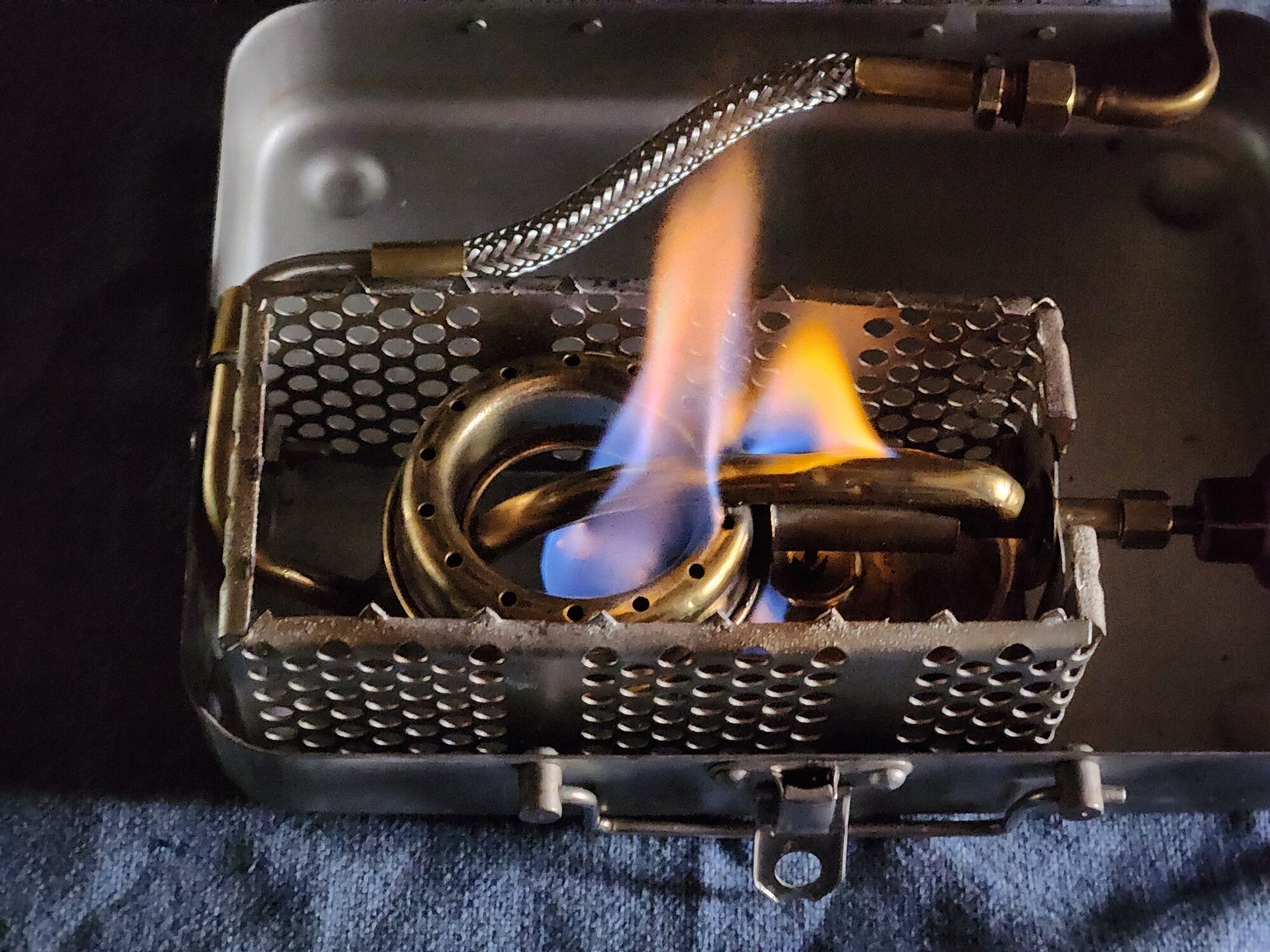

    Priming with Methyl hydrate
    It burns fairly well, but is a little less consistently than gravity-fed alcohol stoves of simpler design. There are two orifices aimed at either side of the vaporizer tube that must stay lit for it to operate properly
