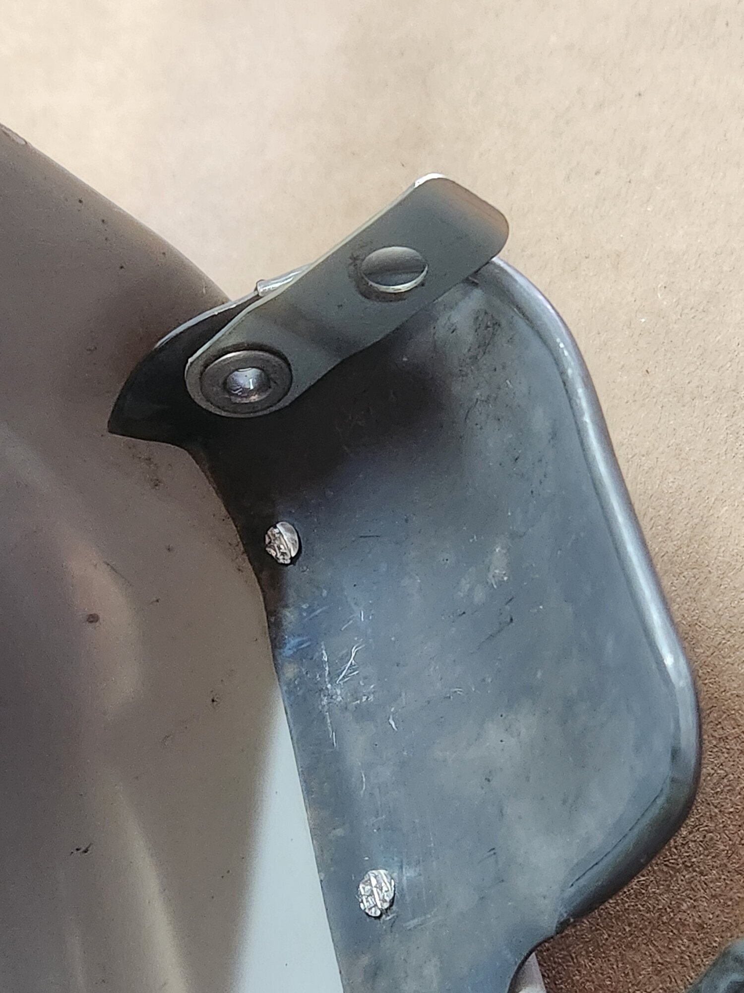

    The clips that hold the funnel, tools, and instructions are in 3 pieces, riveted to the case.

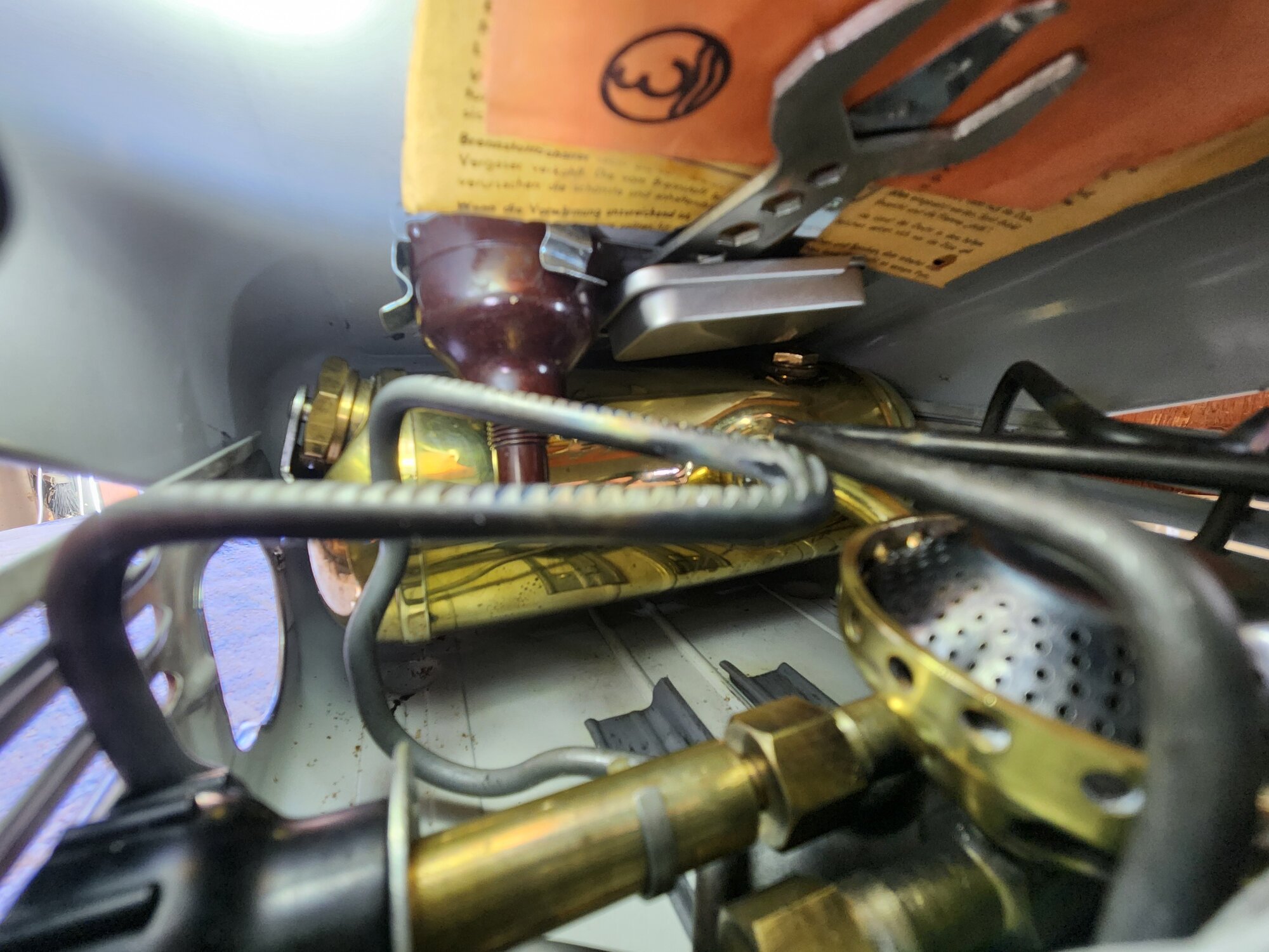

    I attempted to capture what it looks like inside when folded
