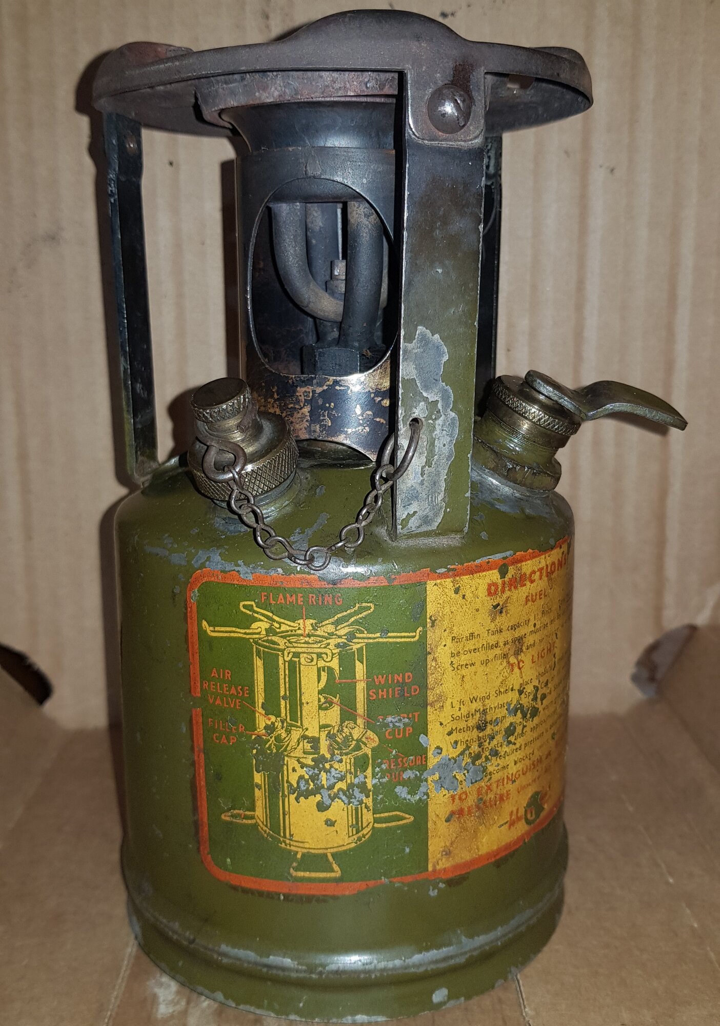

    I had wondered if the OP had sourced a replacement burner. I do have the spares tin but it has only got the screwdriver tool, a number of old washers and lots of pricker wires; no spare jets.

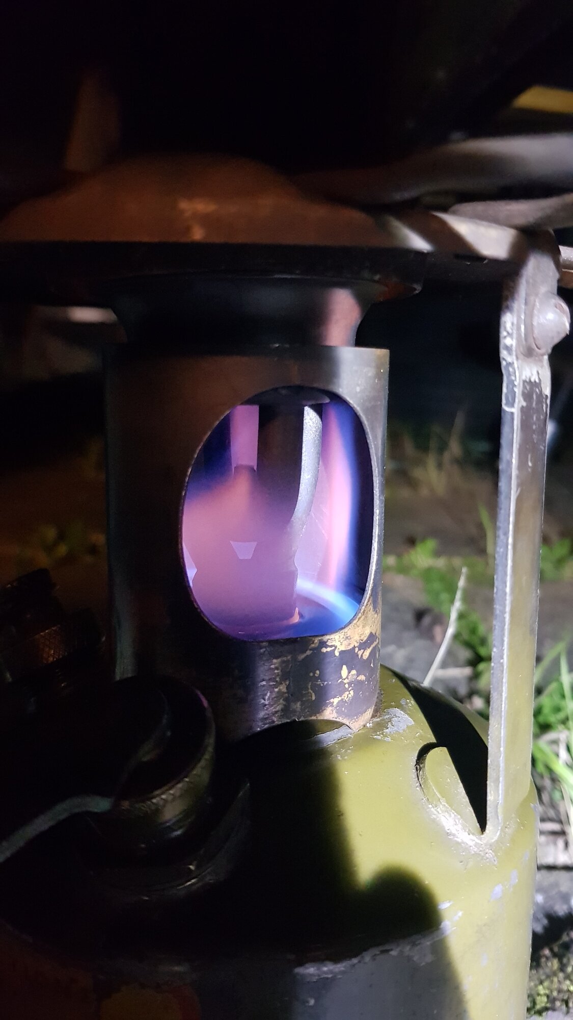

    I have soaked and scrubbed my stove. It was pretty badly sooted up, but i hope not too much carbon on the inside. I think mine looked worse than it was with mould on the sooty build up around the burner and windshield.
    I rebuilt it with new seals and then had a test fire outside. It began well but a strong gust of wind blew the flame out between priming and full roar. I will run it again when I get chance on the weekend.
    I'm so far pleased with the clean up, hopefully well enough but has retained the patina.

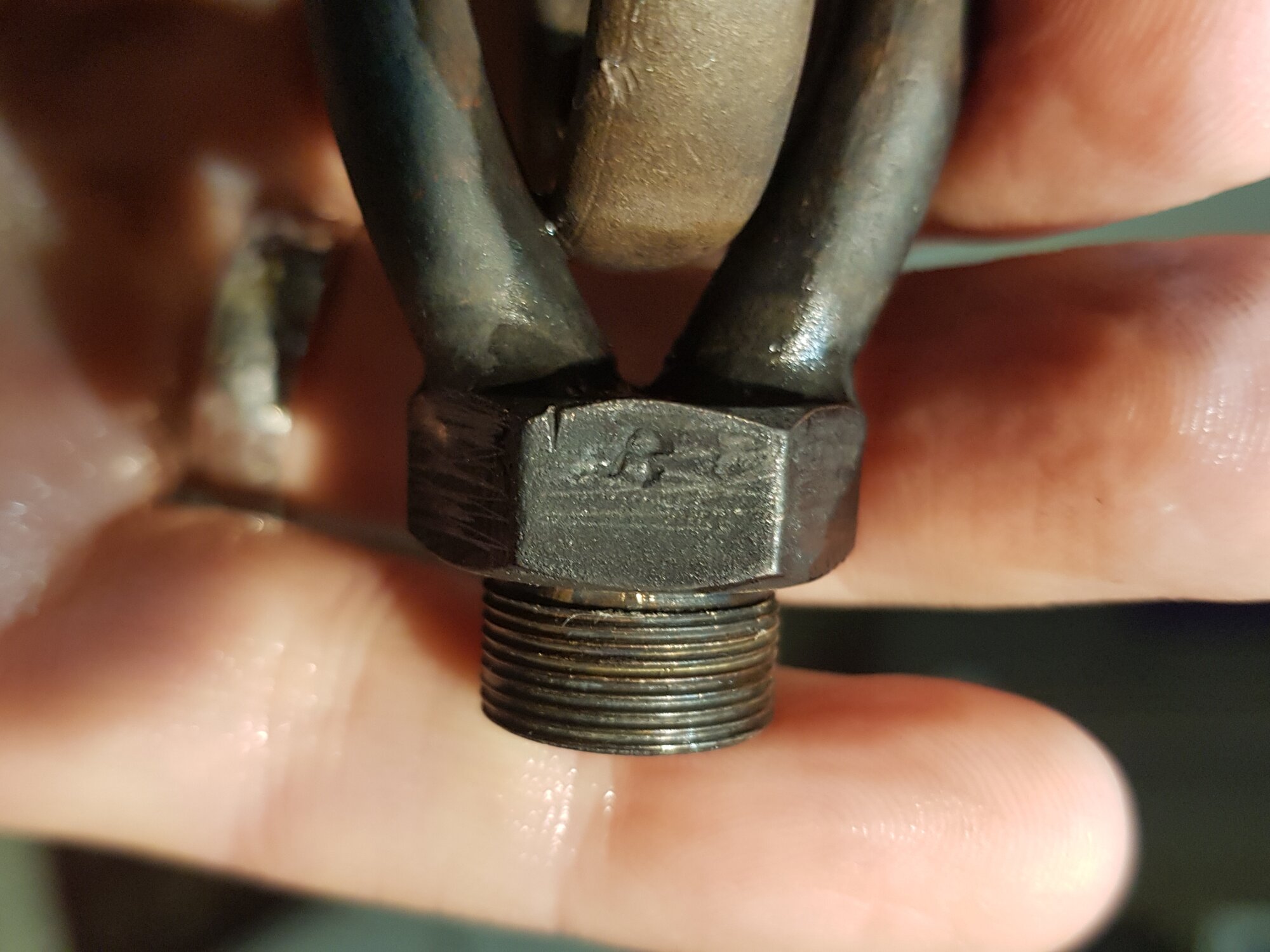

    Thank you @kerophile - I hadnt considered the crossover to Burmos or other burners. I was interested to find a B on the burner nut, Burmos perhaps?

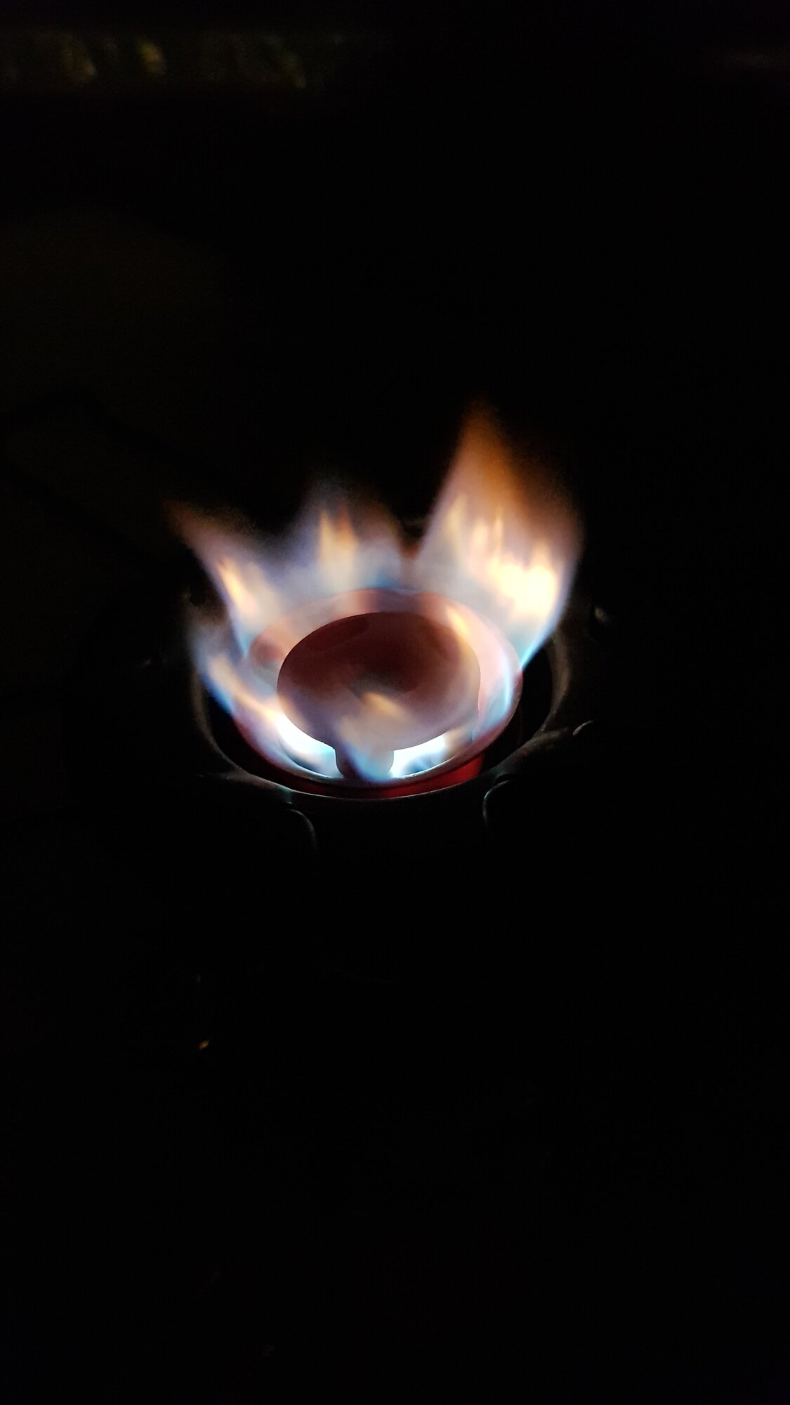

    Do you know of a supplier for new / old jets please? Mine is burning quite orange which I assume to be down to a worn jet / nipple

    @Onfire Sometimes the flame will clean up with use- fresh fuel may dissolve old deposits inside the tank which affect the flame until gone.
    But still quite likely a new jet is needed, and if that fails, a burner decoke. Base Camp sell jets, or have a look on ebay although I believe quality can be a bit variable with these.
    Edited as posted at same time as Kerophile- I would have suggested fettlebox but they've been out of stock for a year or more.
