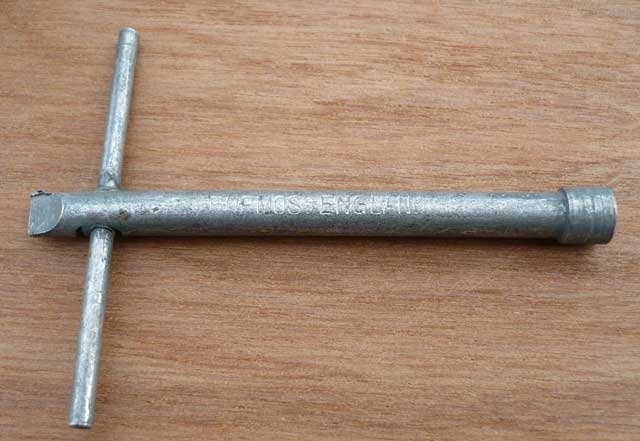

    In the Burmos 21 referred to in his post, Kerophile shows the original Burmos tool with a screwdriver at one end for unscrewing the access screw and a socket to fit the jet at the other.
    Without that tool, a silent burner jet key is an alternative, but only if it can fit through the 9/32 inch (7mm) access hole - not all jet keys are slim enough. A Primus or Optimus one would be but some aftermarket examples may not be.
    An articulated roarer burner jet key isn’t a possible fall back. It’s too bulky to fit through the space it normally could be accommodated on any other roarer burner, but not the Burmos.

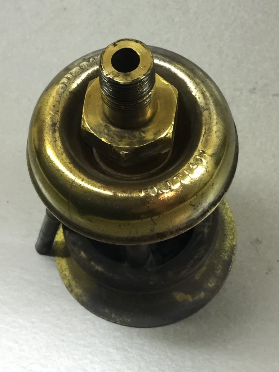

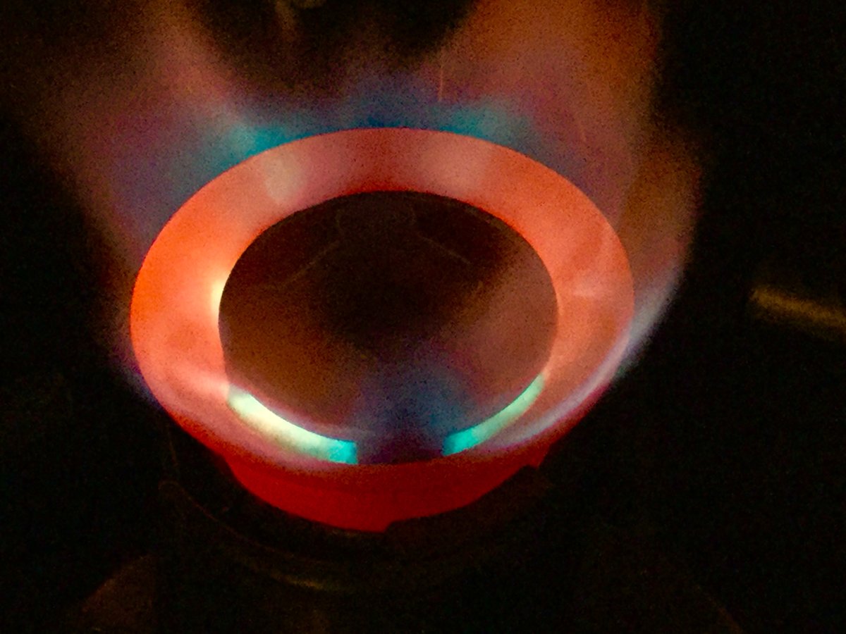

    Something for @Ed Winskill. Ed, you spoke of the ‘copper’ hue to the spirit cup on your Burmos 21 and indeed that was the colour of mine too.
    Plenty of use of the stove this week, with much of this ...
    443FC2DE-3D05-485D-AE24-6FC50F93B803.jpeg 53F08992-CDDC-4481-B351-D58EB19BA1BC.jpeg 566C27F4-90E9-4D3B-AD4D-8AAF55662257.jpeg
    ... resulted in the spirit cup adopting a distinctly brassy colour.
    Here, I’ve taken a smidgen of metal polish to remove the brass ‘tarnish’ (for want of a better word). Evidently the brass colour is an oxide/tarnish that is a surface effect only.
    George (@kerophile), I’d appreciate your thoughts on that phenomenon, given your professional background as a metallurgist and your understanding of the behaviour and characteristics of metals.

    Hi John @presscall it is difficult to answer your question without knowing the precise composition of the brass alloy used to make the spirit-cup.
    In stove making the ductile 70/30 Copper/zinc alloys were commonly used for the tanks, pump tubes and spirit cups due to their good formability by rolling, pressing and drawing. They can also be soldered and brazed relatively easily.
    The burners, knobs and riser tubes were likely made from 60/40 Cu/Zn alloys, which offer higher strength and better casting behaviour.
    Pure Copper forms a copious, black, non-adherent, oxide scale when heated in air.
    The brass alloys tend to form more brass-coloured, adherent, and protective oxide scales when heated. The scale can be lighter in colour than the parent brass due to its zinc content, or Aluminium oxide content, if Al is a component of the alloy. If the thin protective scale is subsequently removed, the colour of the parent brass can be seen underneath.
    So, that is some of the theory, but I would need a full chemical composition of your brass spirit cup to be more specific.
    Many stove manufacturers used brass-plated steel for flame-rings and spirit-cups at times of brass shortages (like War-time production) but I assume that you did test your spirit-cup with a magnet....
  6. presscall
    13,945
    Thank you George (@kerophile) for what I knew would be a comprehensive and knowledgeable reply.
    Shame on me, no, I didn’t test it with a magnet. I just have and it’s plated steel.
    Why the plating takes on a copper hue sometimes and brass after a few stove firings is a mystery, but I’d best go easy on the metal polish to bring about a transformation or I’ll be down to the steel.

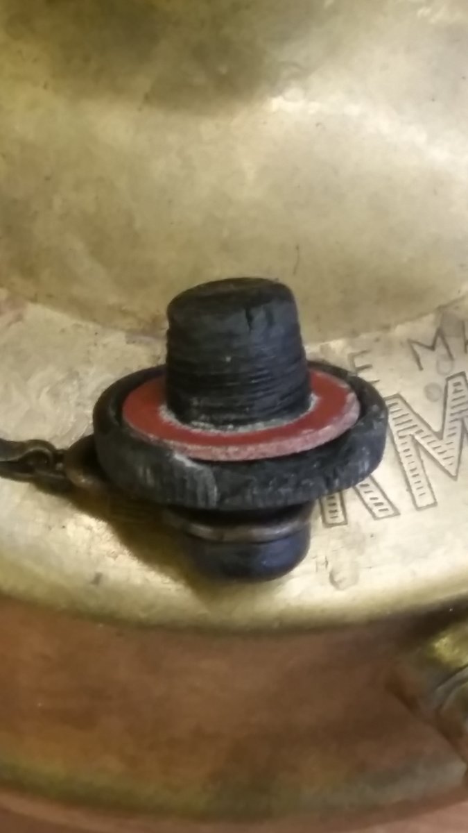

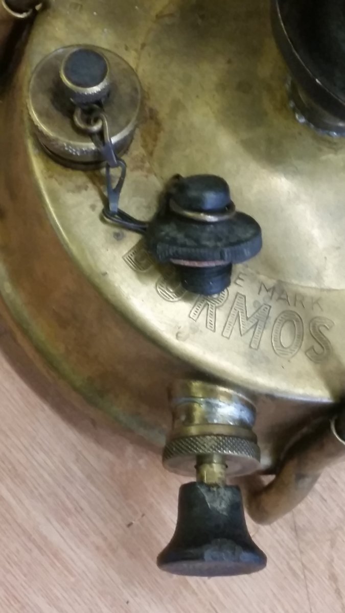

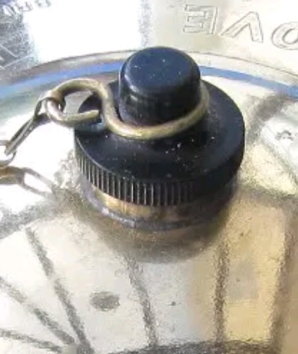

    My two Burmos 21's have now become three! See if you can spot some more bakelite, firstly on my new stove and then on another example from the internet
    Seems pump rod ends weren't the only items to get made from bakelite! Incidentally, both these caps are from 'engraved' founts as opposed to the 'sticker' variety.
    Baz

    I’ve seen another ‘21’ with an engraved tank (as opposed to logo decal) and a plastic pump knob since posting details of that one of mine, but a keeper cap in plastic/bakelite is a complete surprise.
  10. Tony Press
    10,858
    @presscall & @Go Scout
    I have a Burmos with the bakelite/hard plastic keep cap, and what looks like the same material as an (ineffective) pump cup.
    It’s unfettled, but I’ll get photos later today.

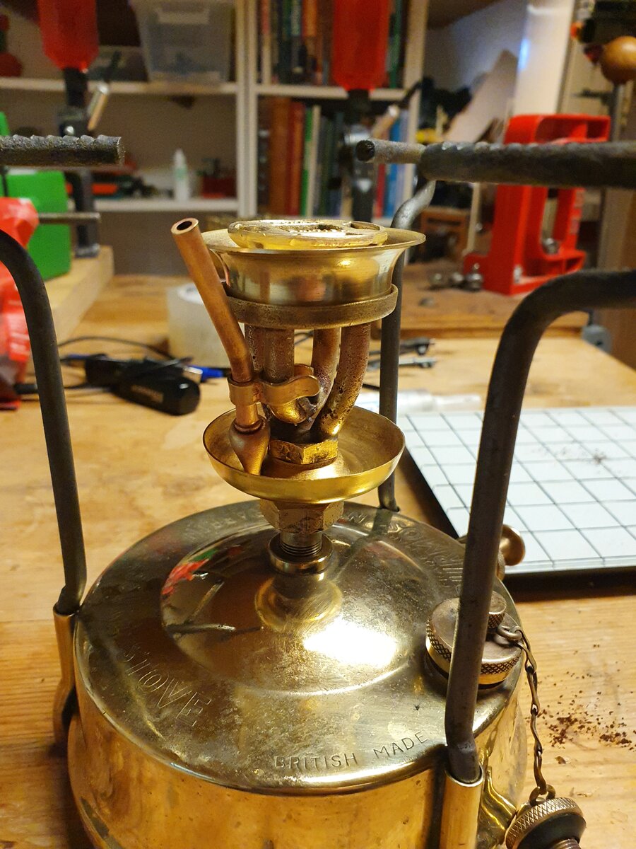

    I have had one of these stoves for more than 10 years never even looked at it before. Fired it up today got a small leak from the centre cap and maybe underneath. Ran ok for no work done. But I have no idea what the metal tube thing is for never seen one before and have a few similar stoves it was just in the tin it came in. I can see from your pics it just sits in a the clip. Thanks. IMG_1301.JPG
  12. Tron
    Tron Subscriber
    Jan 23, 2018
    230
    Norway
    I do not know the correct name, but its a pilot light tube. It should have a clip to secure it to the burner, the wide end rests in the spirit cup and soaks up some of the preheat liquid, and starts a small flame at the narrow end. When the preheat fluid is spent, this flame burns on for a few seconds. If you close the ventscrew and pump pressure in the tank quickly, the stove will light from this flame.

    thank you for such a quick reply i am in australia and thought everyone would be asleep. that is such a good idea I shall give it a go. yours is nice and shiny mine is not, as long as works i am happy. off too make a brew on it now thanks again Tron

    was exactly as you said boiled a pint of water in reasonable time thanks again Tron.
