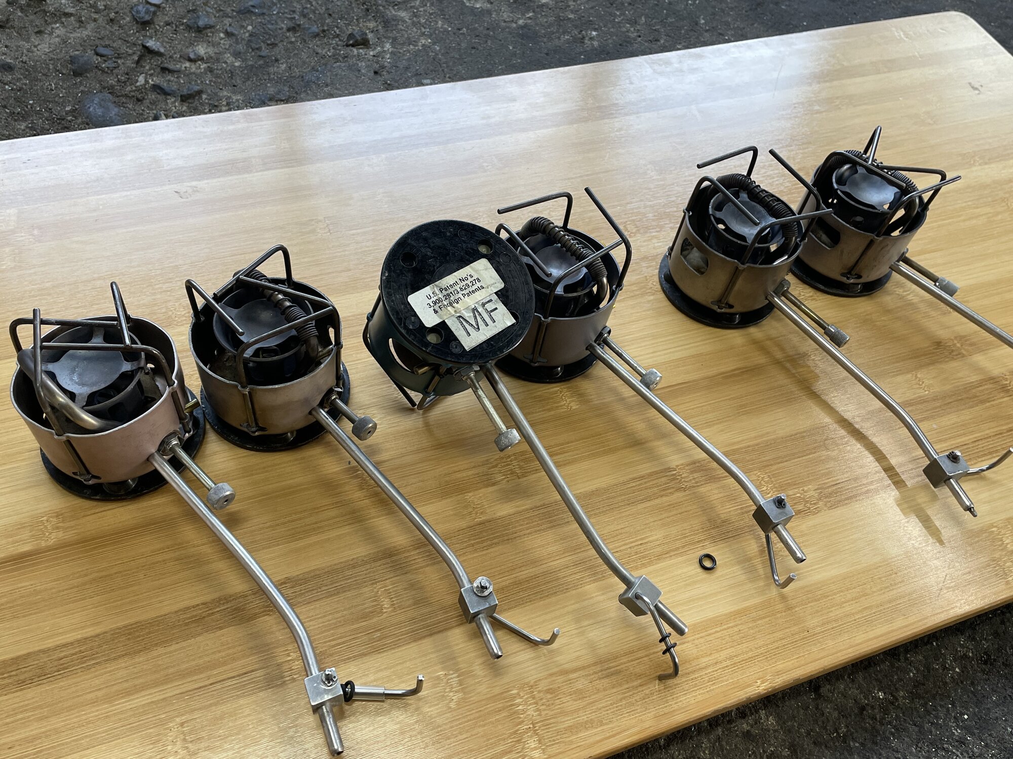

    re my: "There have been well-intentioned stovies invested in the topic that were discouraged here along the way : ( . There are conflicted accounts and inaccuracies." ...and... here we go again : (.
    If there are clear on-point specific corrections (with links to back it up) to the topic, that would be different.
    i stand by all of the above.
    @mojo please do not be deterred or discouraged. You and I have no troubles. There are at times comments that do nothing to contribute to collaborative progress in reference section. it happens.
    mojo,
    this Q&A now very much fills-in the MF burner details. Perfect :thumbup::thumbup:
    It is not all explained in 1 place (not yet) but some missing details are finally confirmed. "I think" we can call MF details done.
    This has been many years and many members. Today mojo wears the hero hat for filling in the last details for the MF versions (i thought, eventually, it was going to be Duane).
    Collaboration is key.

    @mojo "your MF-1" an early MF (MF w/solid helix) narrows age range, that one is Jun/Jul 75 -to- before May 76.
    fwiw early (earliest/ver 1) MF details eg [earliest MF example] Unfired MSR MF continued scalloped burner detail and shipped with the all yellow pump.

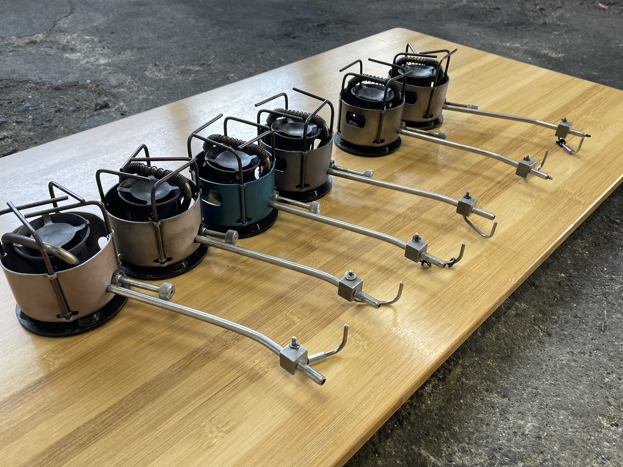

    @snwcmpr
    All the "-1" etc refer to the photographs of the stoves, left to right. MF-1 is the leftmost stove, DF-2 the rightmost. It is a notation that only applies to stoves in @mojo's post below.

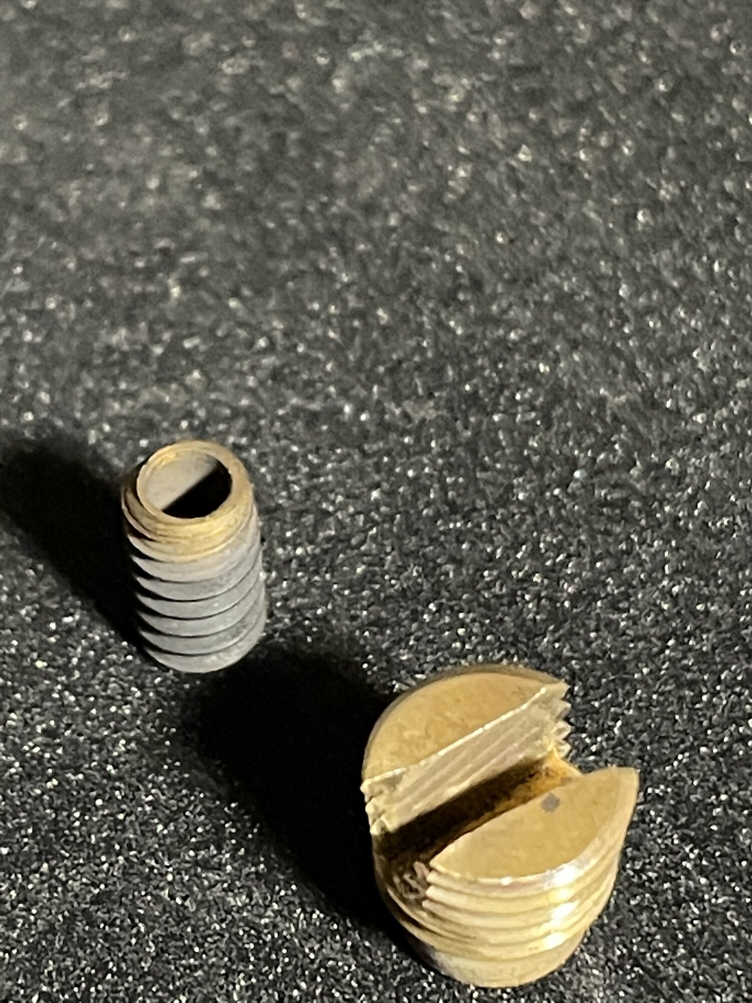

  10. oddball
    Nov 6, 2015
    71

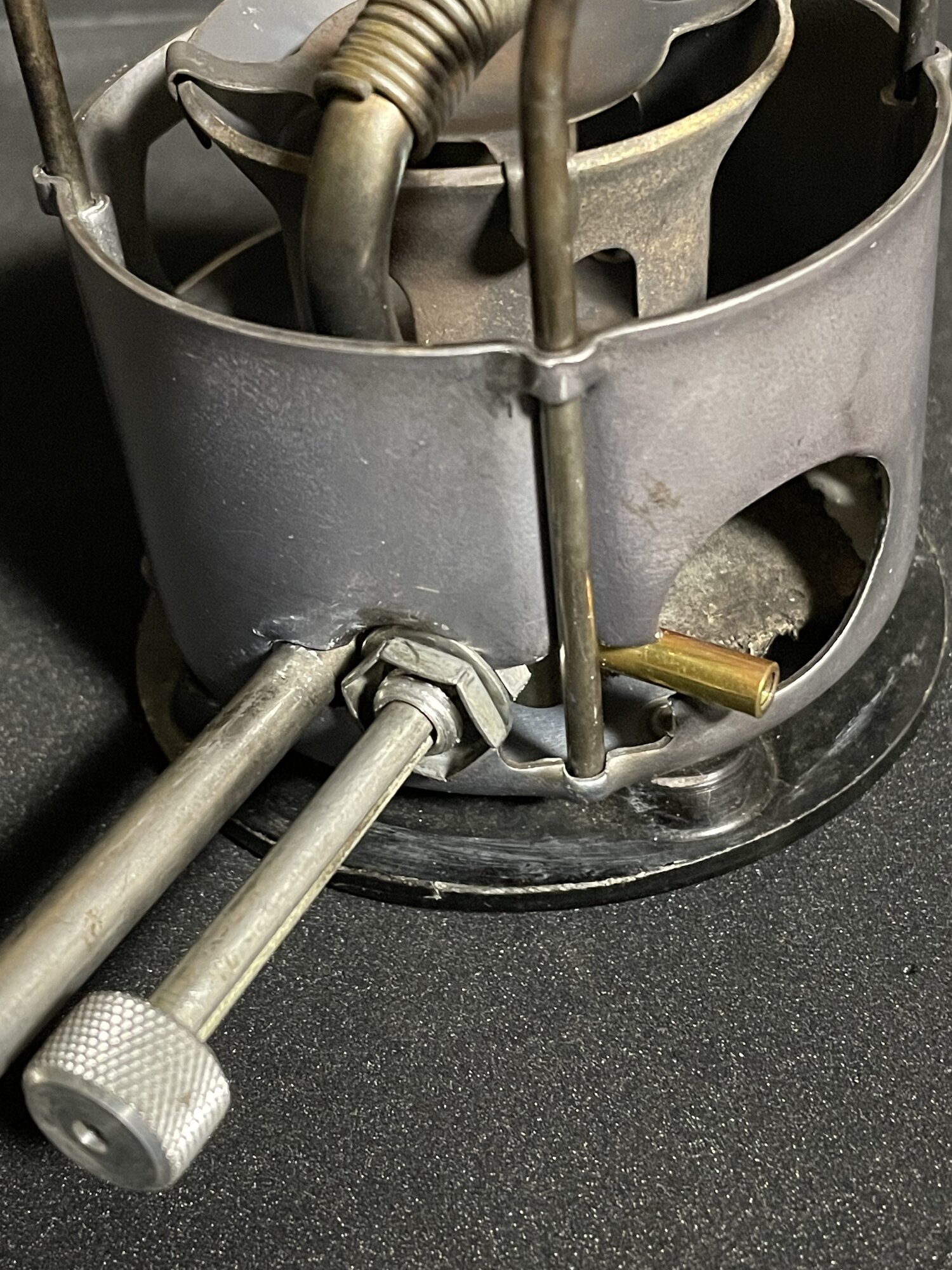

    @mojo,
    Your stove is a Model G/K! Not a DF or MF.
    What makes a Model G or G/K?
    • Unmarked jet is shared between the G & G/K stoves
    • G & G/K jet is larger and will not fit in the Model 9A, MF or DF burner
    • Flexible removable cable to clean out any deposits in the fuel tube
    • The Model 9 original sparker unit is swapped out for the later Model 9, 9MF, 9A, MF & DF sparker units
    The Model G & G/K stoves were manufactured in August 1977. e.g., New MSR Field Maintainable Stove instructions.
    MSR made separate jets for Model G & G/K stoves, c. 1979. The first mention of separate marked G & K jets is 1980.
    Model G & G/K stoves were replaced by Model X-GK on November 2, 1981.
    The stove in the link below is not a DF it’s a G/K.
    MSR Dual Fuel Stove
    Some members here believe this to be a DF based on the instruction sheet. MSR didn’t have time to create an instruction sheet for a new stove they wanted to launch so they included the DF instructions. Notice the box reads G/K. The first Model X-GK, November 2, 1981, shipped with G/K instructions.
    You can see that the stove, MSR Dual Fuel Stove, shares the same fuel tube, filler cable, unmarked jet & sparker unit as your Model G/K.

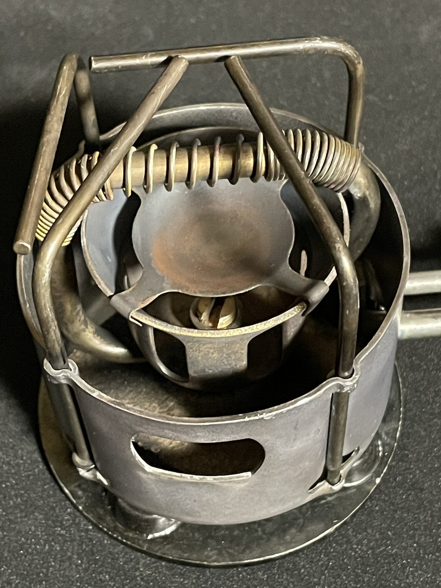

  12. mojo Japan
    Jul 20, 2020
    44
    japan
    Hi everyone, you have given me a lot of explanations.
    I am very grateful to all of you.
    Can I see the definitive DF proof photo?
    I have no doubts.
    I just want to know.
    I would also like to thank @OMC again.
    He was very supportive to me as well.

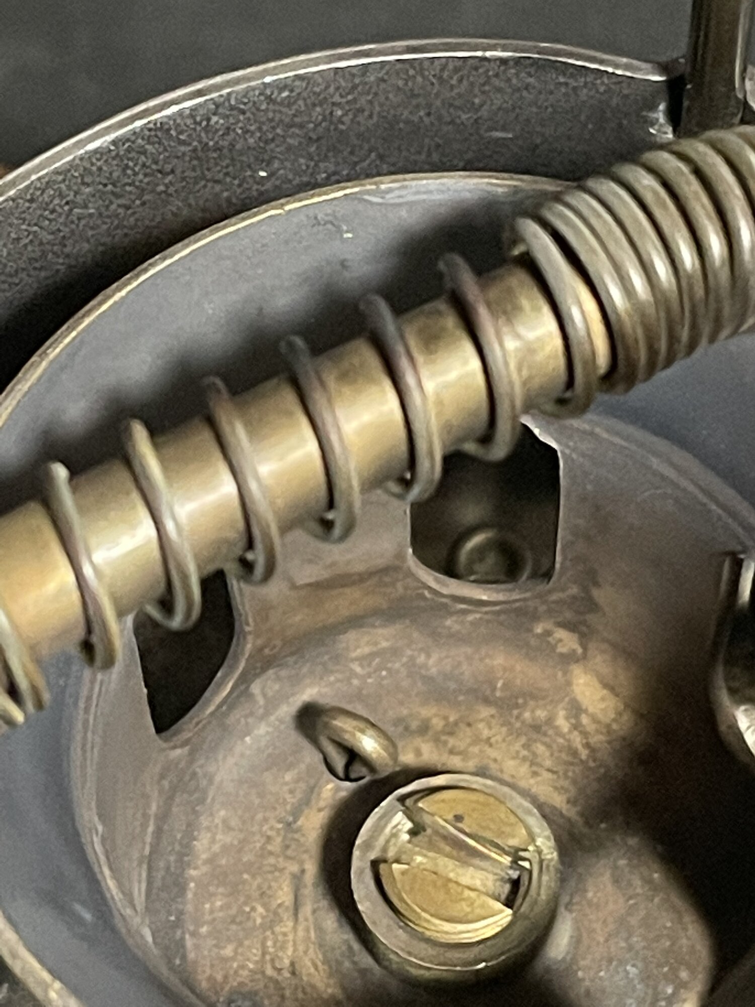

  13. mojo Japan
    Jul 20, 2020
    44
    japan

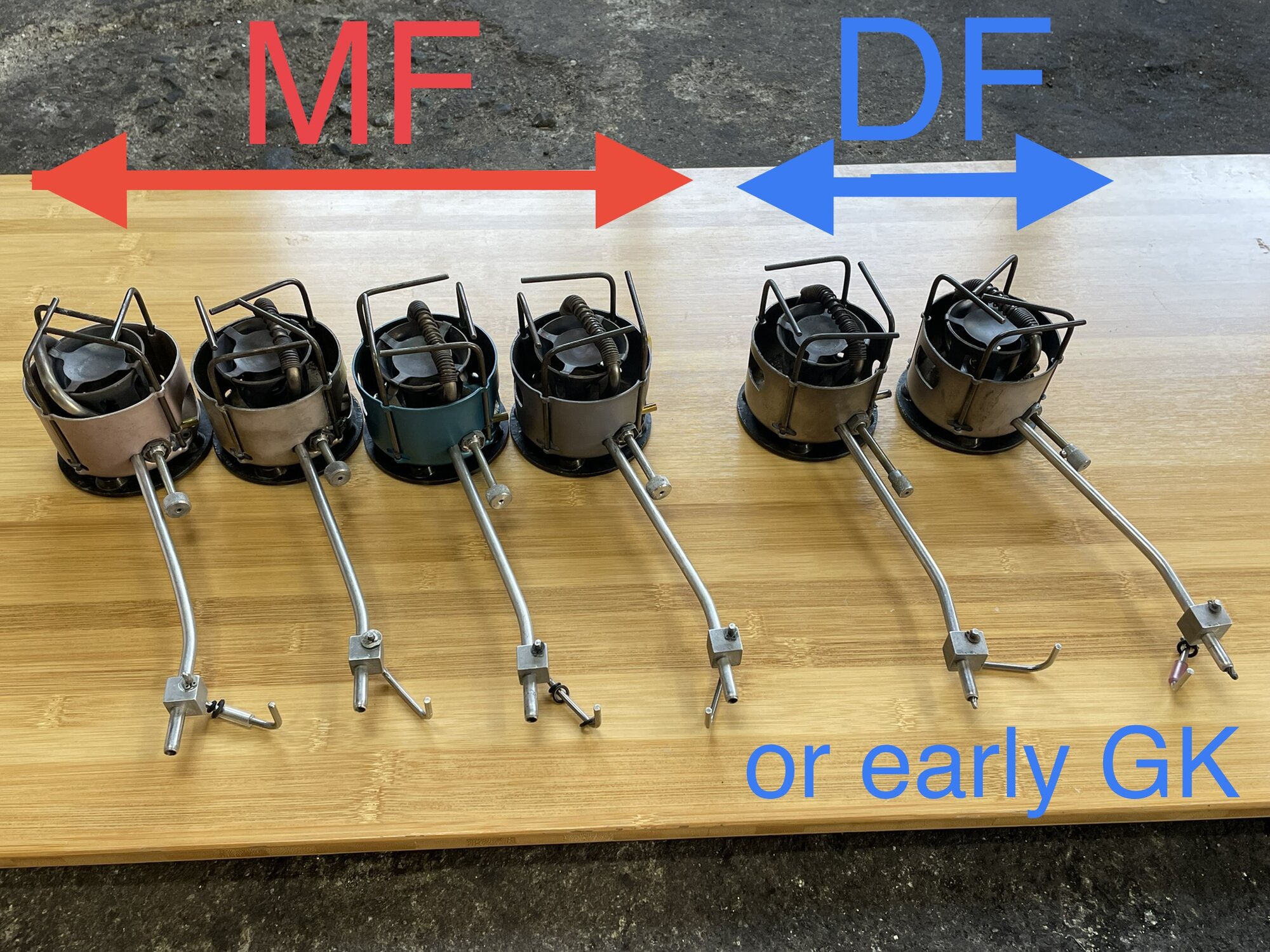

    From MF to GK, how many types of stoves are there? So is this late MF? Or is it DF? I want to see a decisive DF.
    Thank you.
    2AB301F7-E7F1-43E6-837C-A861B1923D8C.jpeg 336C2837-A701-4541-81CF-7D63C90C58CB.jpeg DCA4B9B2-BCB5-4C7C-9EDC-18B6FCAAE532.jpeg 5202AADB-B8EE-49A4-BE42-50DE9B74AFE1.jpeg BF2A4CD0-0513-447C-A2E0-81201F94F605.jpeg E2A3CFD6-642D-44A1-B011-598F93A07D75.jpeg

    OMC United States Subscriber
    5,758
    @mojo
    re your: "I want to see a decisive DF."
    join the club : ) .
    There are DFs (w/paper labels) out there in-circulation. It's seems odd no more have surfaced and no one is sharing details of such a find? :-k Every month that passes increases the chance that any paper DF label out there will fall off.
    There are "DF"s posted but for whatever reason, posts are not conclusive and questions re details go unanswered.
    re your: "So is this late MF? Or is it DF?"
    That is a good question. You do have good questions and comments :thumbup:
    FWIW my position Mar 2019:
    The last known version of MF, it seems even more likely now, is identical to the 1st version of DF.

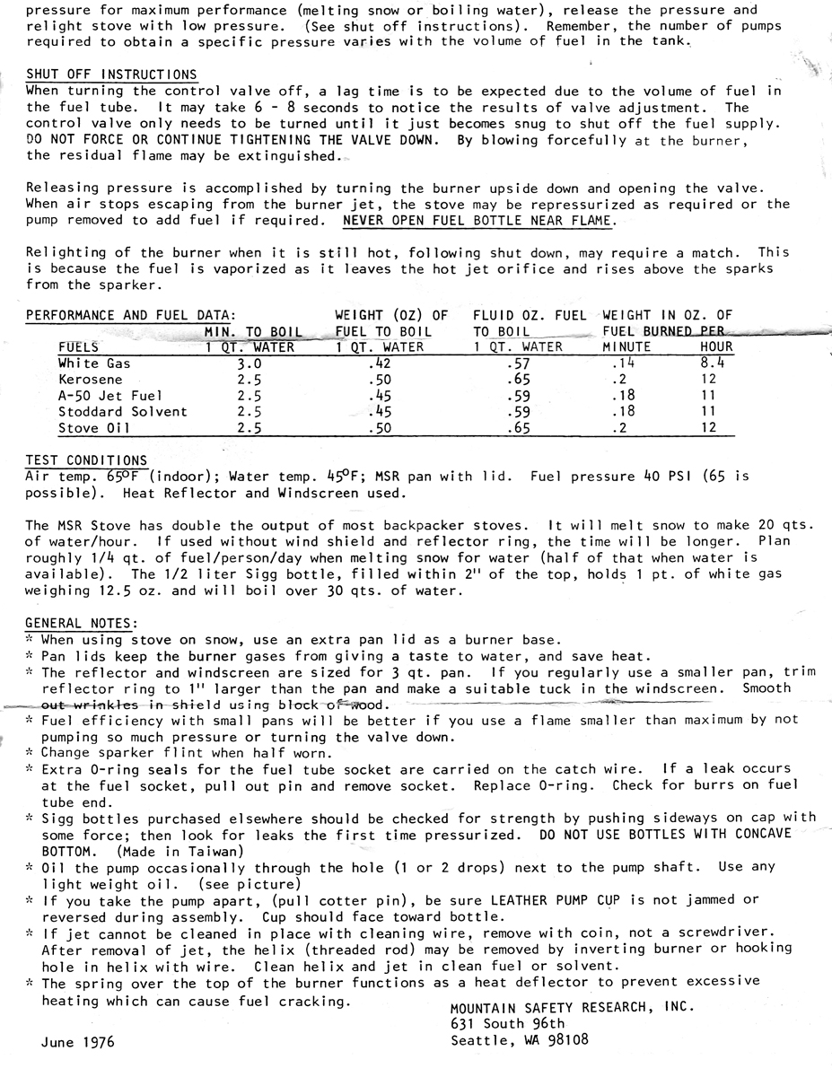

    We've known, June 76 DF (&MF) instructions refer to "...helix ... removed ... or hooking hole in helix with wire..."
    [ an aside, so far, all burners with helix have early small burner that is threaded to the top (not wide top) ]
    >> caveat (challenge), MSR has on occasion distributed paper that is conflicted or in error.
    "ON paper" the 1st DF did have "hole in helix". This is where i remain (last MF & 1st DF=same) given what we've seen....
    Of course, lots of things look good "on paper" that in reality are not so (all things not just MSR).
    Sad news, if we pater confirm track record that the last MF & 1st DF are identical... who is to say the last DF and 1st GK are not the same...? aw geez. don't blame me i'm just the messenger.
    Sorry this is long (difficult translation) and sorry i am not more concise.
    In my defense DF details are complicated to attempt to sort thru. and i do strive to be accurate.
    cc @oddball cc @Scrambler i am hoping you follow what you can as your time allows.
    I am out of time, no where near ample time in this week to handle an increasing workload (worked til 11P last night on "day off"). Will catch up when i can.

    @mojo re your "From MF to GK, how many types of stoves are there?"
    i will rephrase your question
    From MF to first/early G/K, how many types of stoves are there?
    (there are different versions of G/K).
    Now, with your help, as far as i know we can answer re MFs.
    MFs, the first is quite different, it is rare. It is an MF version, we might set aside as it does not compare (closely) to all other MFs.
    That leaves the next, more common, 2 (or 3) MFs:
    early MF (not the first, that is unique unto itself)
    late/last MF (defining first/early DF will shed light on this)

  16. oddball
    Nov 6, 2015
    71
    @mojo @OMC
    One! The Model DF, which happens to be the Model MF. The stove in the photos you posted could be an MF or DF because they’re the same stove. Read on!
    Here is a decisive Model DF. MSR makes FIRE
    The Model MF and DF are the same stove using the same jet and helix coil. There is no difference between these stoves other than the fuel recommendations in the instruction manuals.
    Model MF recommended fuels:
    Coleman, Chevron Blazo Fuel, Kerosene, Jet Fuel, Stove Oil or Stoddard Solvent.
    Model DF recommended fuels:
    Coleman, Chevron Blazo Fuel or Kerosene.
    There were probably too many complaints about the Model MF clogging from the Jet Fuel, Stove Oil and Stoddard Solvent. The easy solution would be to rename the stove Model DF (Dual Fuel) and remove the Jet Fuel, Stove Oil and Stoddard Solvent from the Model MF (Multifuel) stove instructions, which they did.
    The MF and DF instructions have the same date, June 1976. Yet the Model DF does not make an appearance in the Newsletters until March 1977.
    Shown here are the MF and DF instructions that appear to be identical except for the description of the fuels.
    1976_mf_instructions.jpg 1976_df_instructions.jpg 1976_mf_instructions_back.jpg 1976_df_instructions_back.jpg
