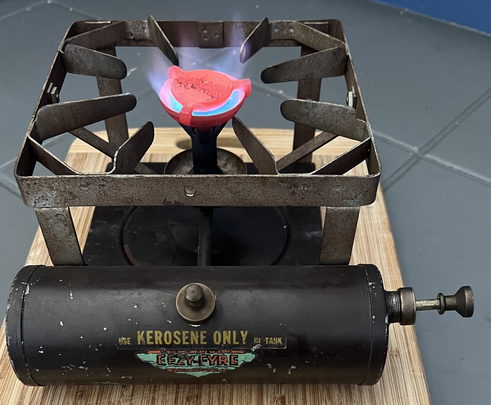

    Update:
    Yesterday I received a small amount of 6.3mm Viton sheet from which I punched out a 4mm NRV pip.
    I have now restored the NRV with its original pip carrier and it’s working well!
    The pump rod is protruding because of the pressure necessary to overcome the spring resistance not because of leaking…
