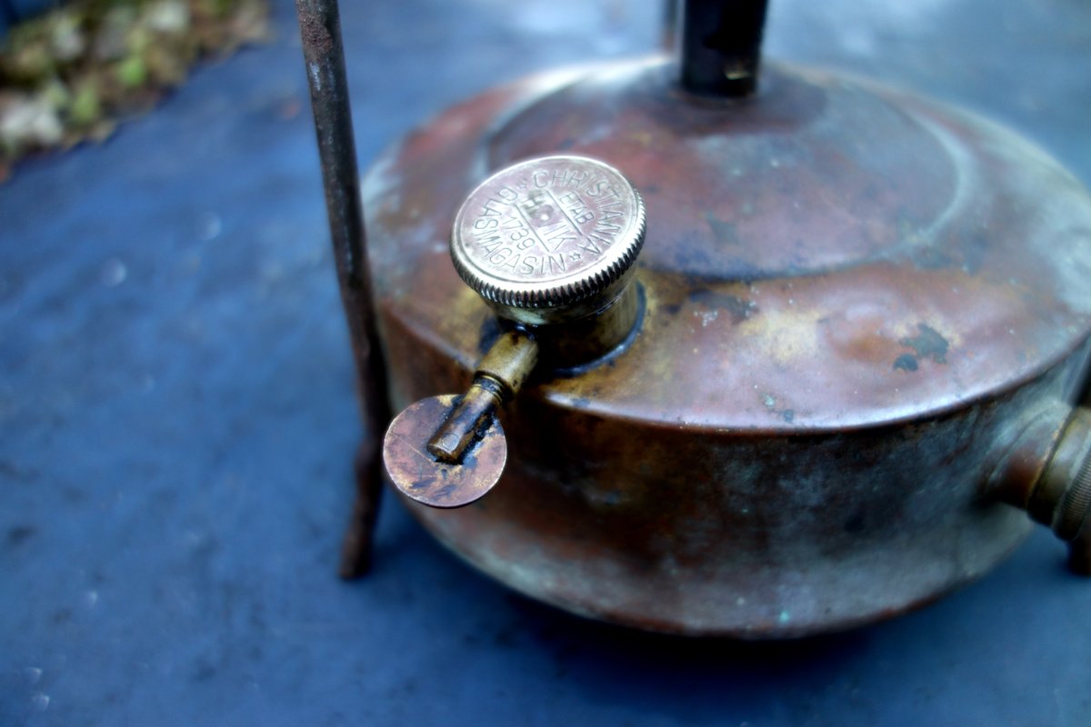

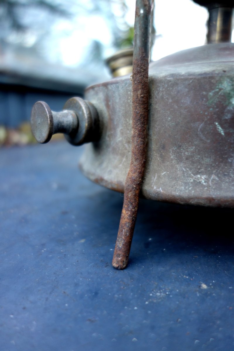

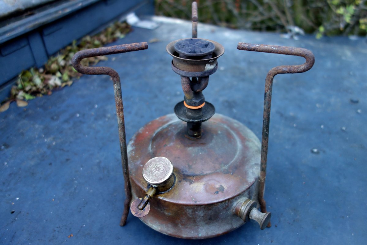

    Here we have a largely unrestored early Høvik Værk No.1 type stove.
    The only markings are 'CHRISTIANIA GLASMAGASIN. HOVIK. ETAB 1739' (Christiania Glass-holdings, Hovik, established 1739), Christiania Glasmagasin was the parent company that owned the Hovik works, on the filler cap:
    and a very tiny, impressed, 'HØVIK VÆRK' (Hovik Works) on the tank base:
    All of the various features of the stove, other than the distinctive form of the pressure release key, closely mirror the design of pre-1911 Primus No.1 stoves:
    If this is pre-WW1, however, the pump rod assembly would suggest that it could not be any older than c.1908/9 at the very earliest. It is uncertain, however, when exactly the production of pressure stoves at the Hovik Works actually began. Historical sources suggest that there was a big movement to promote home based production of all sorts in Norway that started immediately after WW1, so that may be the sort of time production of these stoves began. On the other hand later dated Hovik produced stoves were marketed using their own new 'Standard' brand. The 'Standard' brand was definitely established in use by 1924, so this stove must be earlier than that.

  2. z1ulike
    4,537
    Very nice stove. I especially like the pressure relief key. Do you think it is original or a well made replacement? I've never seen another like it.

  7. ArchMc
    ArchMc SotM Winner Subscriber
    4,682
    Mojave Desert, California
    Ben, @z1ulike
    It looks identical to the one on the Victoria.
    (I keep promising myself to post this one in the SRG.)
    ....Arch
  8. igh371
    2,867
    Durham
    @ArchMc you are absolutely dead right about the pressure screw, fancy that! Just coincidence? or evidence of copying from, or a link to, Nyberg/Sievert? (c/f Victoria here). Ian.
  9. igh371
    2,867
    Durham
    Update following on from this exciting new post by @Håvard Kvernelv. The stove in that post differs from this one only in respect of the air screw key and the fact that it bears the name 'STANDARD' on the tank. It is also accompanied by this advert taken out by Christiana Glasmagasin in May 1912:
    The inference would seem to be that the stove presented above was made only very shortly before the finished version shown in the advert and Håvard's post, i.e. most likely 1910±1 or 2.
