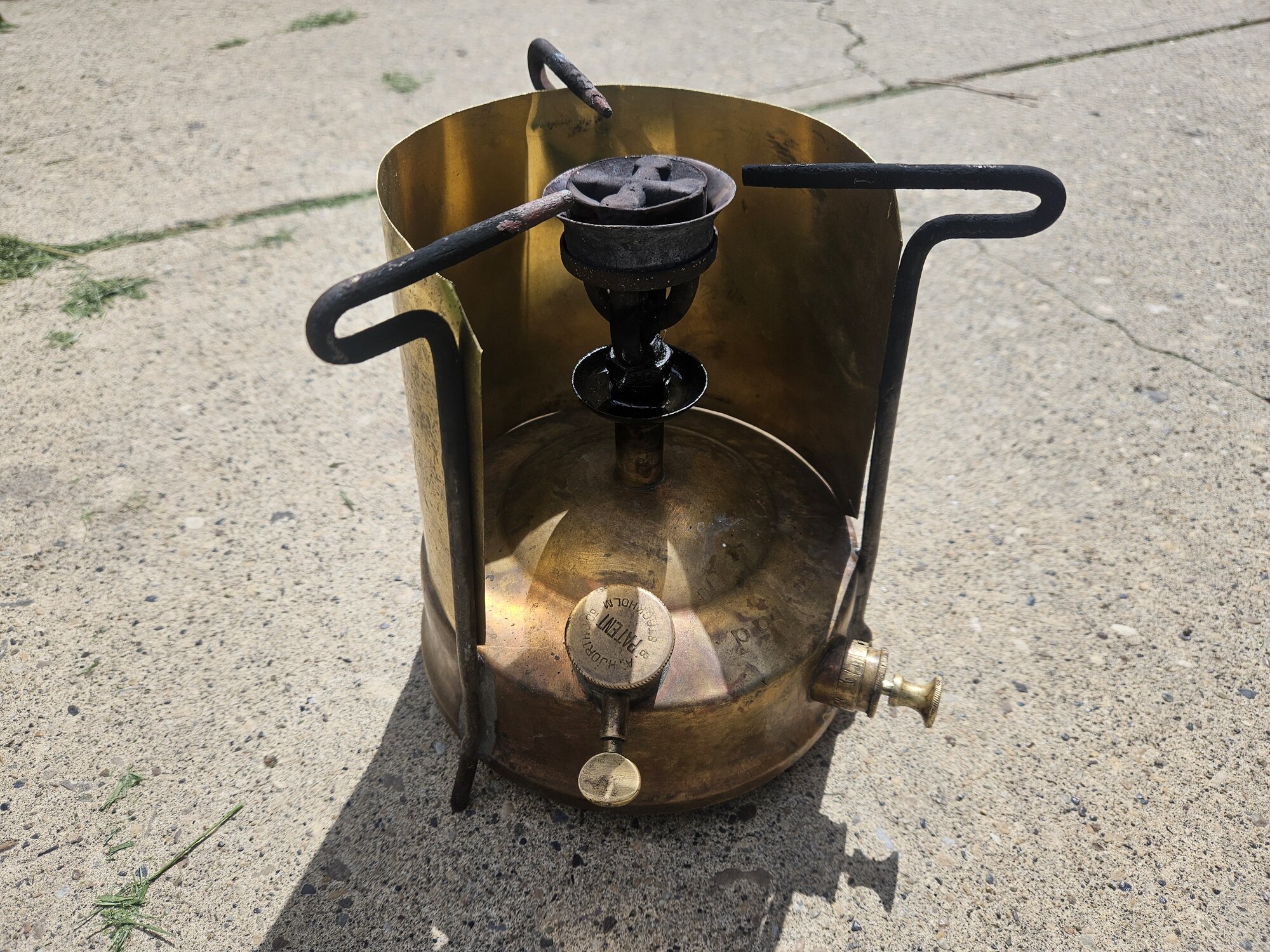

    Well, it's been over a year, but I've finally gotten to fixing this stove. It took a bit of solder, a new fuel cap gasket, and a thorough nozzle cleaning, but it finally roars.
    I tested it out on a breezy day, and found the flame to be sensitive to sudden gusts. I looked away a minute and the flame died and I was left with kerosene to clean up. I've also made a wind screen out of some sheet brass, hopefully that'll do some good.
