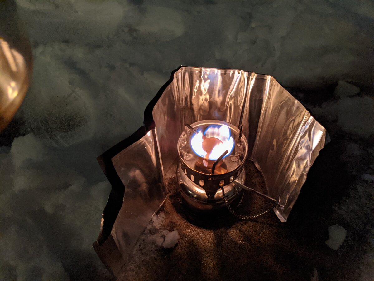

    Lixada gasoline stove -15°C winter test

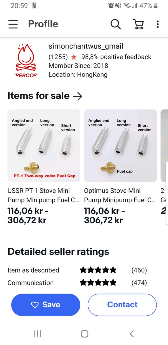

    I spoke to this guy on Ebay
    simonchantwus_gmail
    He makes pump caps for different types of stoves and he said that he is in the process of making a pump cap with SRV for the Lixada, it will be available in about a month for anyone interested.

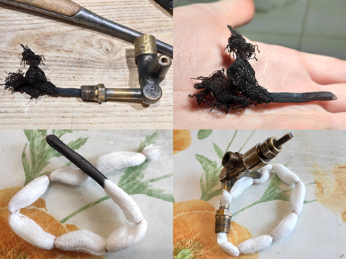

    My way to restore the wick. Its for PT-1 (8R clone, restore it now), I did the same for the Lixada.

    LIXADA gasoline stove - my little story) i can't call IT "a normal wick"

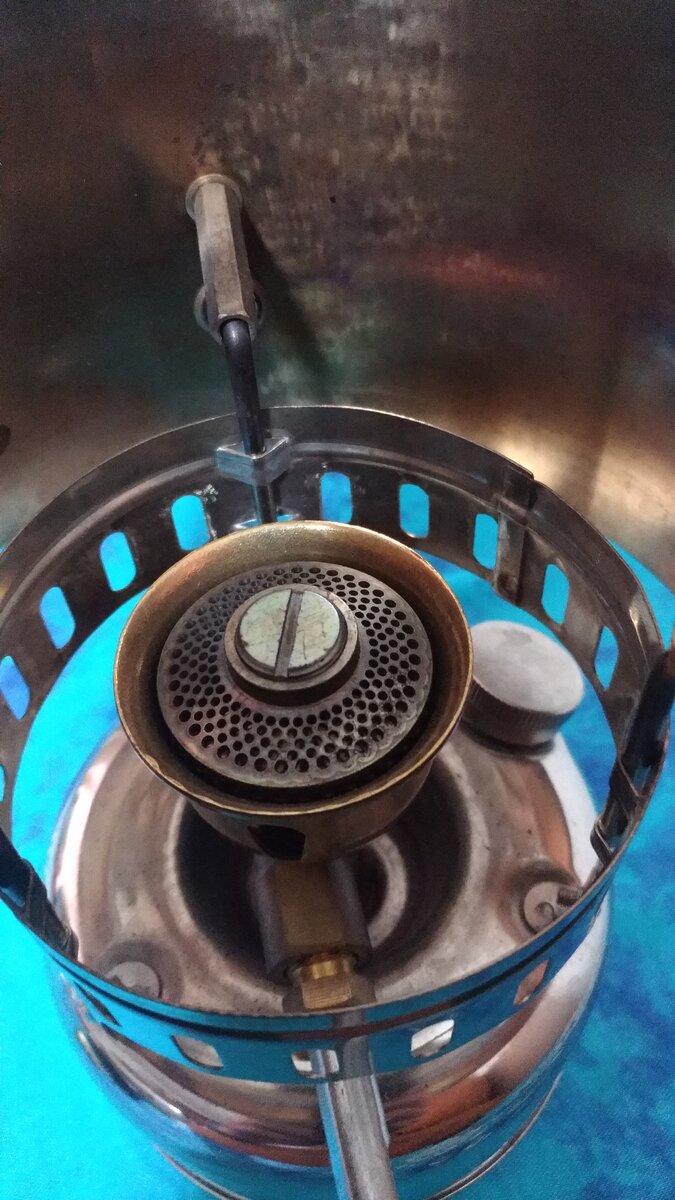

    Hi, here is what I mean by to low inside, I don't think
    the air mixture with be right because of that. I will have a look at the Korean one.
    IMG_20210212_101718.jpg IMG_20210212_101547.jpg IMG_20210212_101603.jpg IMG_20210212_101624.jpg

    Works with kersose. It took 5 mins to get fully primed. And even then it burned pretty dirty, and took 10 mins to boil 2 cups. Adding a windscreen made the process of priming go much better. I'm not too concerned about overheating with a windscreen during priming - esp since the vapor pressure of kerosene is so much less than gas.
