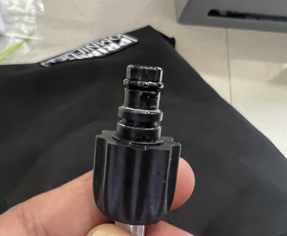

    sample , 1999 sample thanks Yun! and sample in box [w/(ergo debut) pump4]

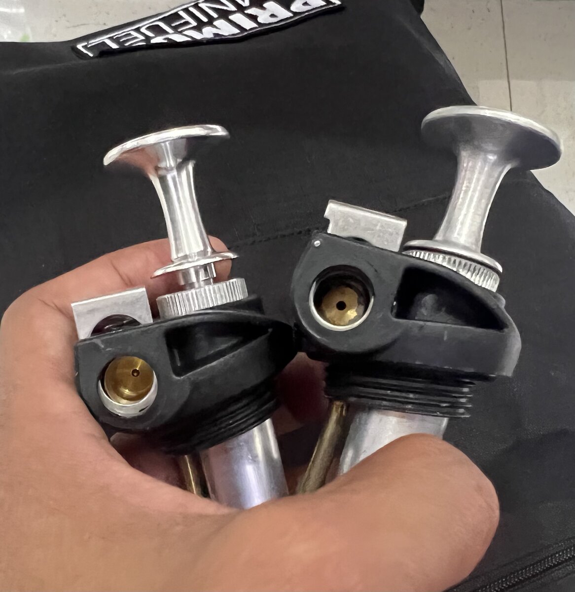

    Hi. Anybody here can help me with my primus himalaya pump? I bought a replacement pump from primus but it has a different connection. Im having a difficulty inserting my fuel hose.
    picture attached;
    left is the new one
    Right is the old (broken one)
    see the difference?
    Now im having a difficulty inserting my fuel hose to my new replacement pump.
  8. Blantka Germany
    Nov 17, 2021
    45
    Germany
    Edit: I am sorry, I was confused by this previous picture of the old aluminium pump. Please ignore my reply... :-( I thought you want to attach a CEJN connector into the new ErgoPump.
    Actually I think you are mixing several things up:
    • there is absolutely no need to remove the rotatable connector out of the new ErgoPump (!). This part should always stay inside the pump - it is only getting removed in case the rubber sealing suffers some leakage (to replace the rubber sealing)
    • the new ErgoPump is designed to screw a Lindal valve hose connector onto this brass thread of the rotatable connector, it is NOT designed to remove the rotatable connector out of the pump and plug in the old version CEJN connector instead...
    • the big advantage of Lindal valve connectors is that they can be used with gas cartridges also. Primus does only use Lindal connectors nowadays.
    Unfortunately I have to tell you that your old hose connector is not compatible with the new ErgoPump connector. While the new ErgoPump has a screw-on Lindal system, the old connection type (that you have been using on your aluminium pump) was using a CEJN plug-in connector.
    To resolve this, you should be able to replace the complete fuel hose (which is attached to the stove) with a new version hose that has a Lindal connector instead of the old CEJN connector that you have been using before.

  10. Blantka Germany
    Nov 17, 2021
    45
    Germany
    On your second picture in the previous posting (the picture where you held both ErgoPumps close to each other) it seemed that you have removed this rotatable Lindal valve connector from both pumps.
    The new ErgoPumps have this Lindal valve connector that you can see on the following picture (brass part on the right side). There is no need to remove this part, as you can screw on the hose directly onto this brass thread.
    Could you take a picture of your whole stove set? Including both pumps and the hose incl. connector?
    Apparently you are using the old version ErgoPump with the previous CEJN-connector I guess. It looks like that:
  11. Pedros Philippines
    May 13, 2022
    5
    Philippines
    I actually manage to solve the problem. I changed the oring with a smaller size . Stove working fine now. Thank you very much!

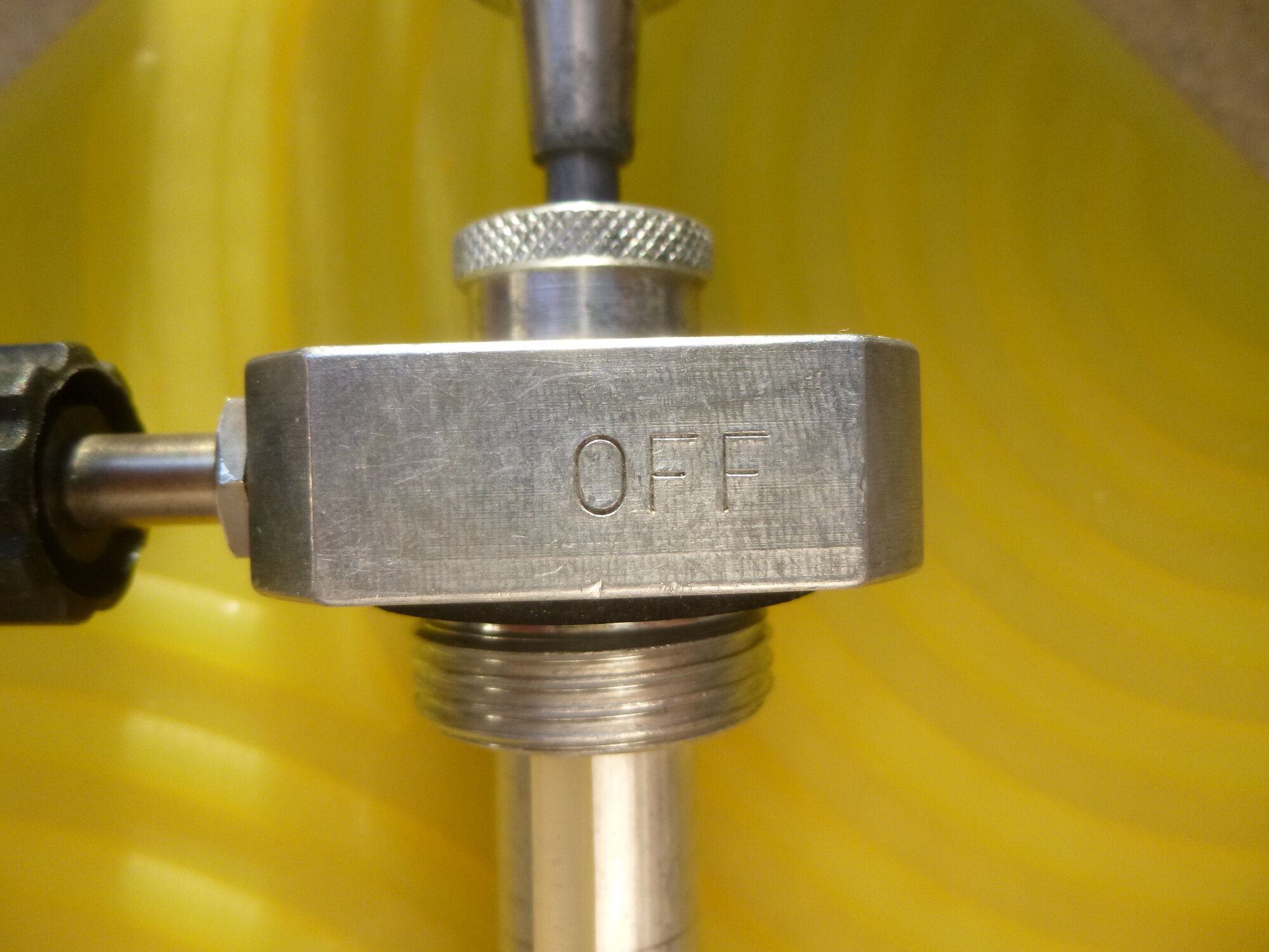

    A bit off topic from the o-ring thread. I cranked up my Varifuel 3278 yesterday. It's been a P1070580.JPG P1070581.JPG while. Ran amazingly strong. I've misplaced the instruction sheet and was wondering what the "on" run side & "off" other side are in reference to? These are both stamped on the top of the aluminum pump block.
    Merci Beaucoup
  13. stormking
    Oct 10, 2004
    7
    Colorado
    I learned when flipped to the "off" position, excess fuel in the line is burned off eliminating it from pouring out when disconnected.
