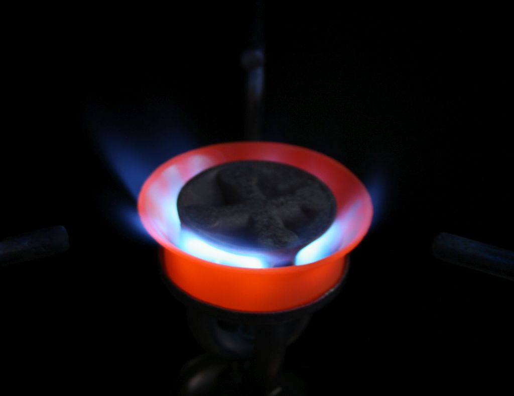

    I'm calling it a "fighter" as it took quite a bit of fettling to get it going - even though it was represented to me as being fully working. The copper washer in the middle photo just above was leaking, so it got replaced with a Fettlebox replacement. I had to do the same for the joint between the riser and the spirit cup, it initially had a very thin gasket, but it also leaked. This particular joint needed two gaskets, one above and one below the spirit cup, as the riser did not have a shoulder for the spirit cup, which would have only required one gasket.
    The fighting did not end here - upon first lighting post gasket replacement, the flame kept blowing out. The wind isn't too strong here today, I'd call it more than a breeze though, but should not have been able to blow it out. After several nipple cleanings, it finally ran nicely, and the breeze was now unable to blow out the flame.
    Then, I went to add more pressure, and the flame blew out! Another pricking and things were back running nicely. I suspect it might have some junk in the tank. I'm using the inexpensive "red kerosene" that I buy locally which is not the best quality, so I don't mind dumping it in order to clean out the tank.
    Finally, it was running nicely:
    This last photo is of particular interest. This kettle is brand-new...and when this photo was taken, had been on the stove for about 5 to 10 minutes. Notice that there is *zero* accumulation of soot - you can see the reflection of the flame in the steel. After boiling about 6 liters of water (it's a big kettle) there was no soot on the bottom, just some white powder that seemed like it may be ash? For sure, once this stove got burning correctly, it had only blue flame and had no odor. This might be the cleanest burning kerosene stove I own?

    And a couple of photos as the sun was going down today... :)
    Thanks much!
