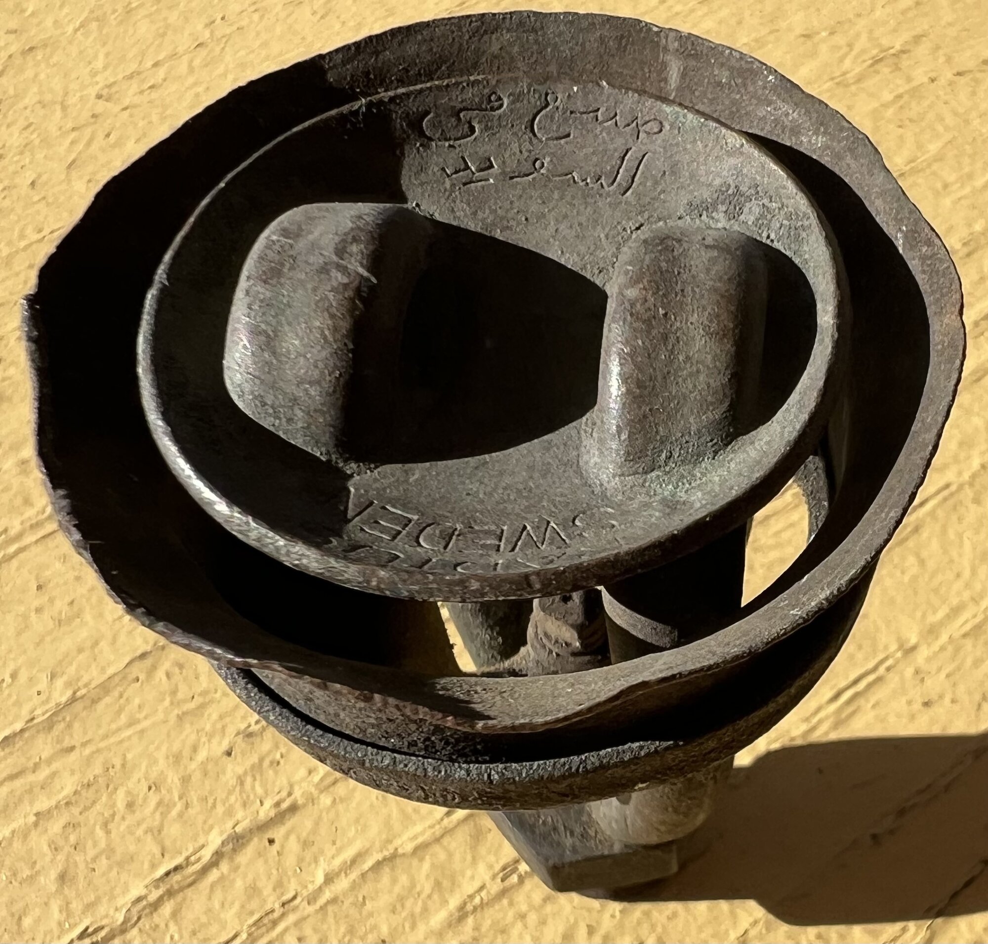

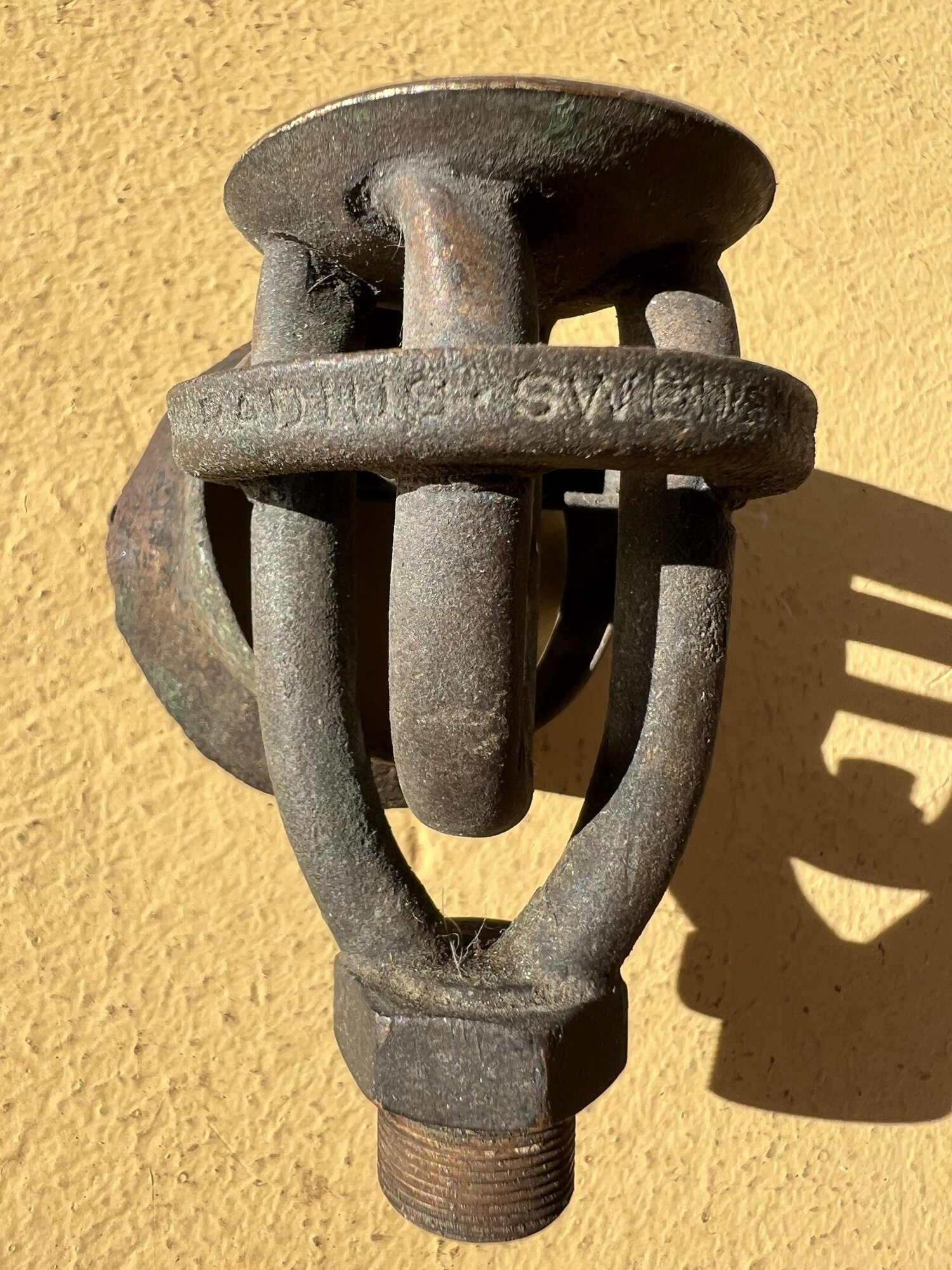

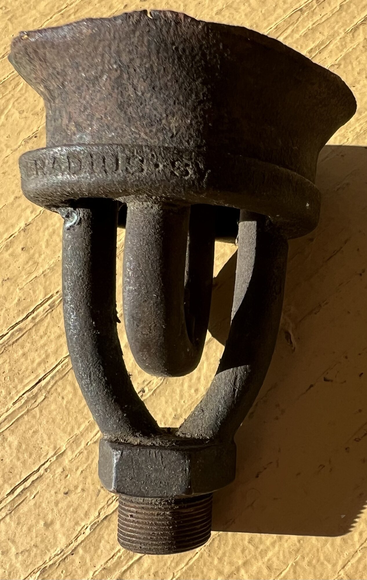

    I recently located this in the "spare parts" drawer of an antique shop...
    It caught my eye because of the the "routing" of the riser tubes - I've never encountered one like it.
    I wasn't able to decipher the script in the fifth photo and currently don't have access to wire brushes/cleaning tools.
    I was unable to "unearth" any similar burners in the Radius catalogues...
    Thoughts?

    @Rodger Willows that’s a pretty amazing burner, I never seen it before…
    Regarding the writings… could be Upplands Vasby?
    Nicola

    Yes I know the 800/801 Svea burner, this Radius doesn’t seem to have a flame plate like the svea.
    Probably the earliest Radius roarer burner datable about the first years of the company? 1913/1914 contemporary to Svea 801? Wow

    I am also aware of its existence, but have never seen a record of it. No patent number...
    It still exists quietly in the history of radius that we have not encountered.
    Maybe an Indian product could be a copy of this, but...

    Agree with above, definitely a very close approximation to the Svea tube burn roarers which were just contemporary to the establishment of Radius after the Primus strike. Maybe producing 'generic ' spares would have been a quick way to establish some sales record?

    The presence of the Arabic text maybe suggests a possible period, but I have no idea honestly.

    abbreviated PAT APPL (patent applied for)
    Rodger might eventually confirm.
    That context introduces makers copying each other (as they did) and makers "applying" for patents to defend against the constant copying that was the norm.
    It would seem be Svea got the patent and Radius did not. This is an intriguing puzzle piece.

    @OMC I think that you are correct with "PAT APPL". That was my first impression.
    In terms of size - it is similar to a No. 1 (Primus 128, R128, 4128) 2 pint.
    It's manufacture would (I assume) have been quite laborious with all of the bending required, hence the limited production and change to the more familiar style of roared burner.

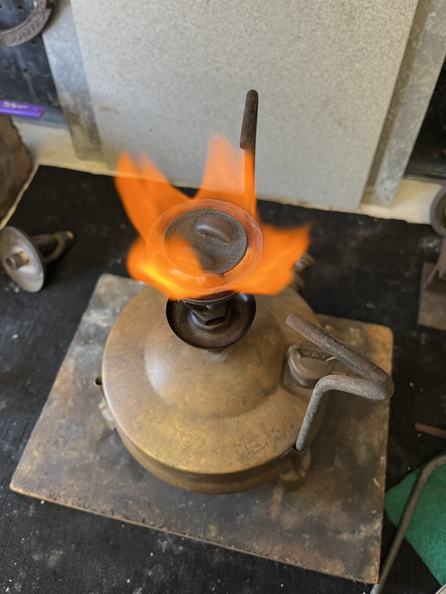

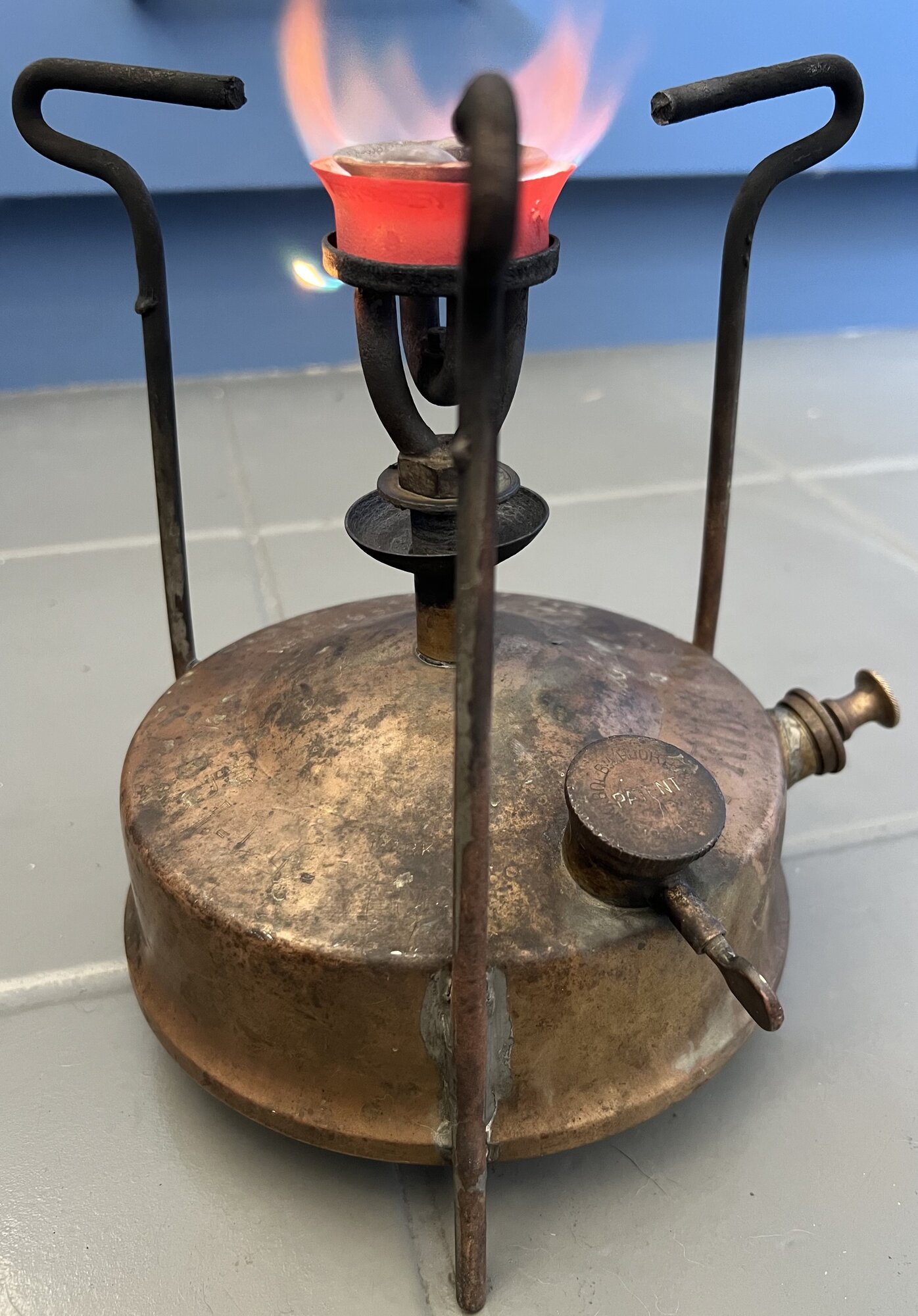

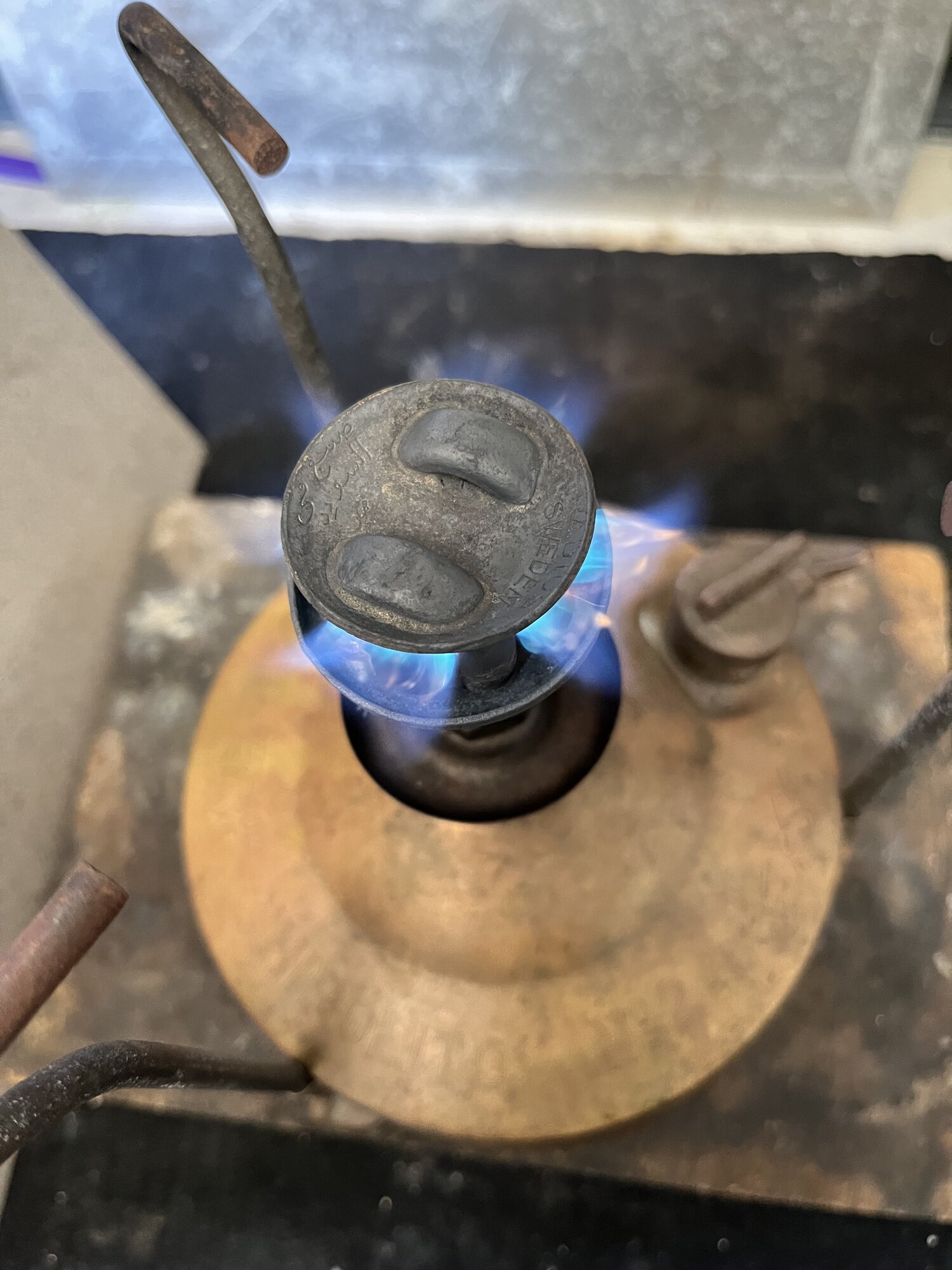

    Today I had the opportunity to fire this one up.
    All I did was prick the jet and apply the suitably distressed flame ring before firing.
    All as one would expect so far

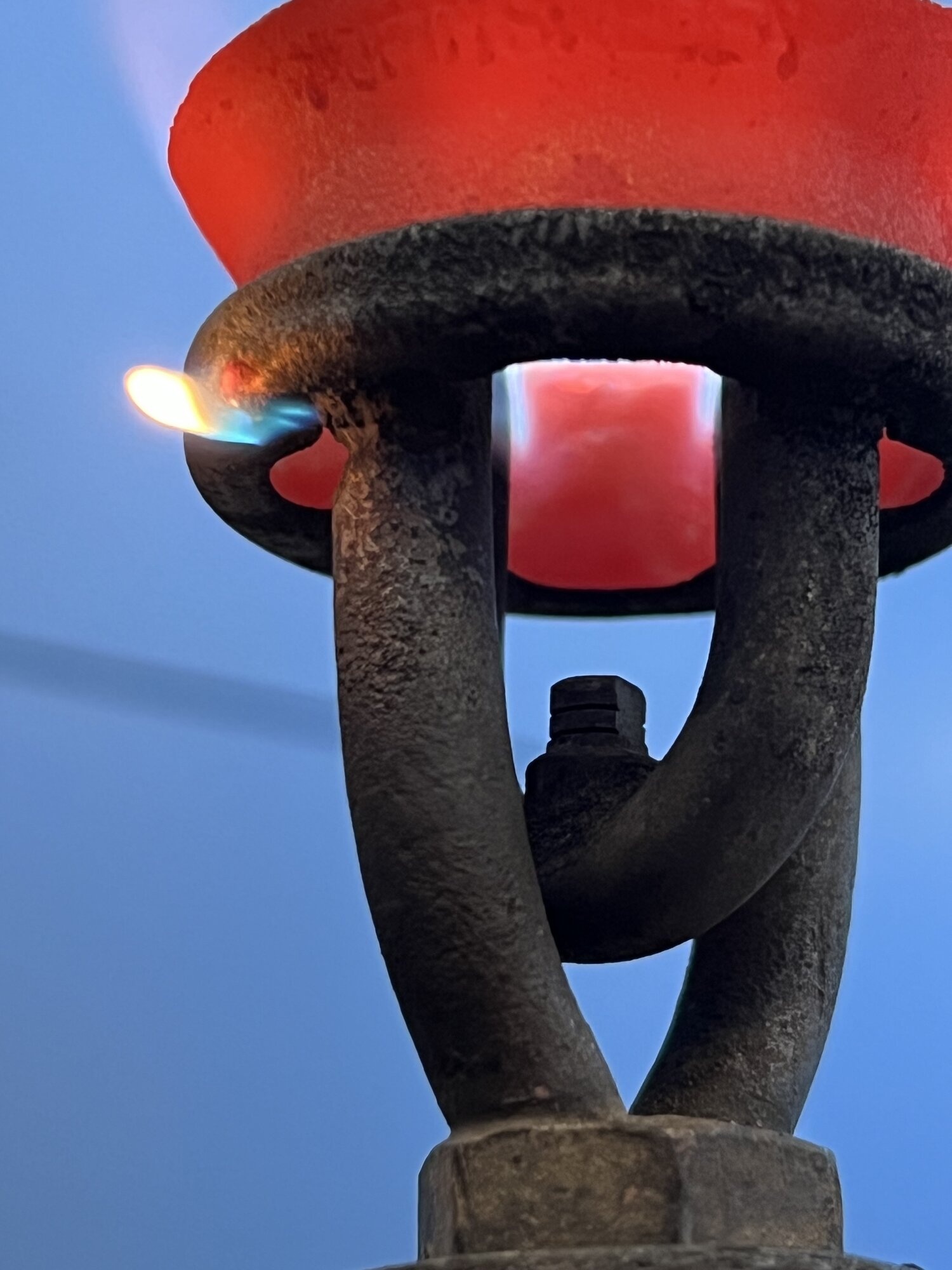

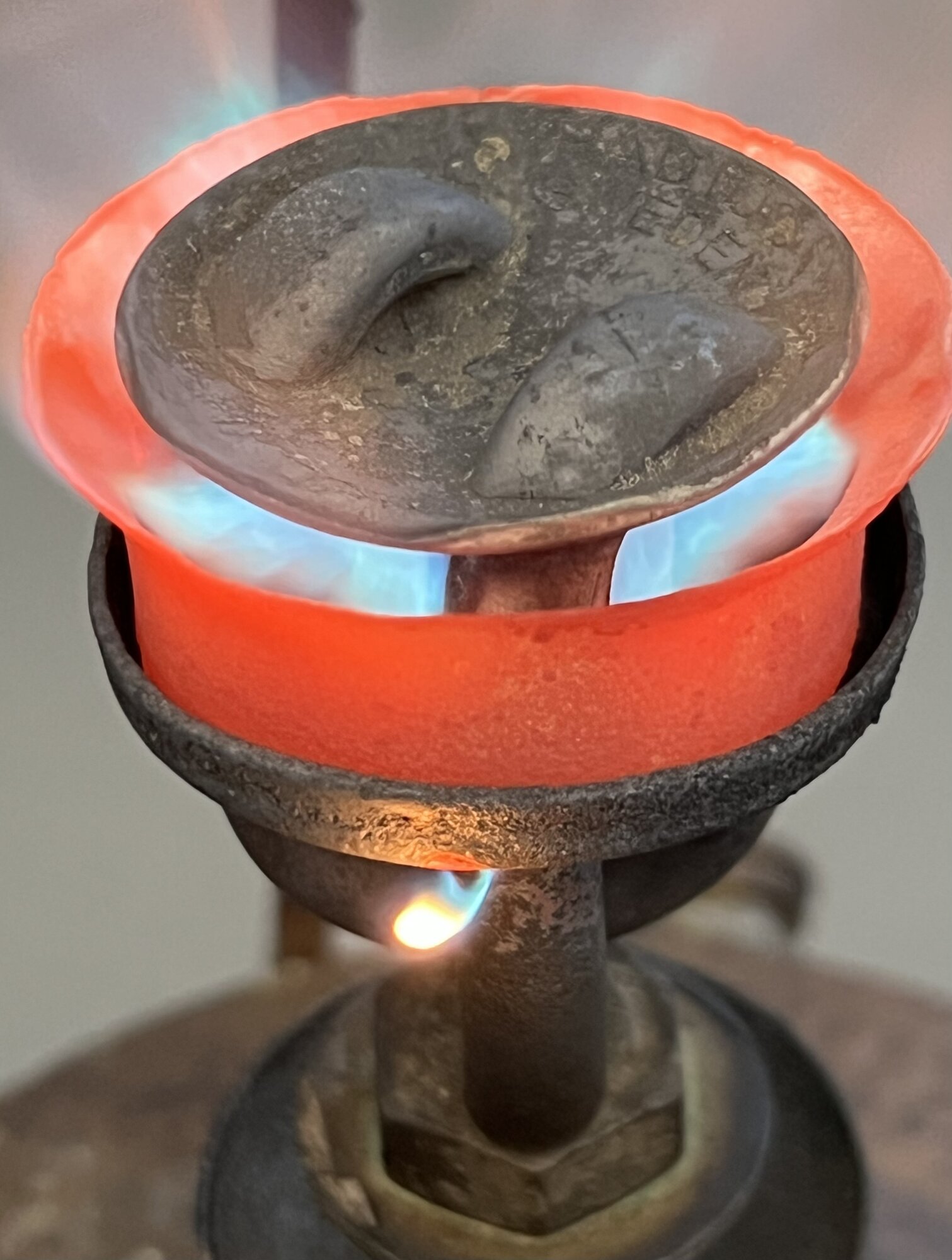

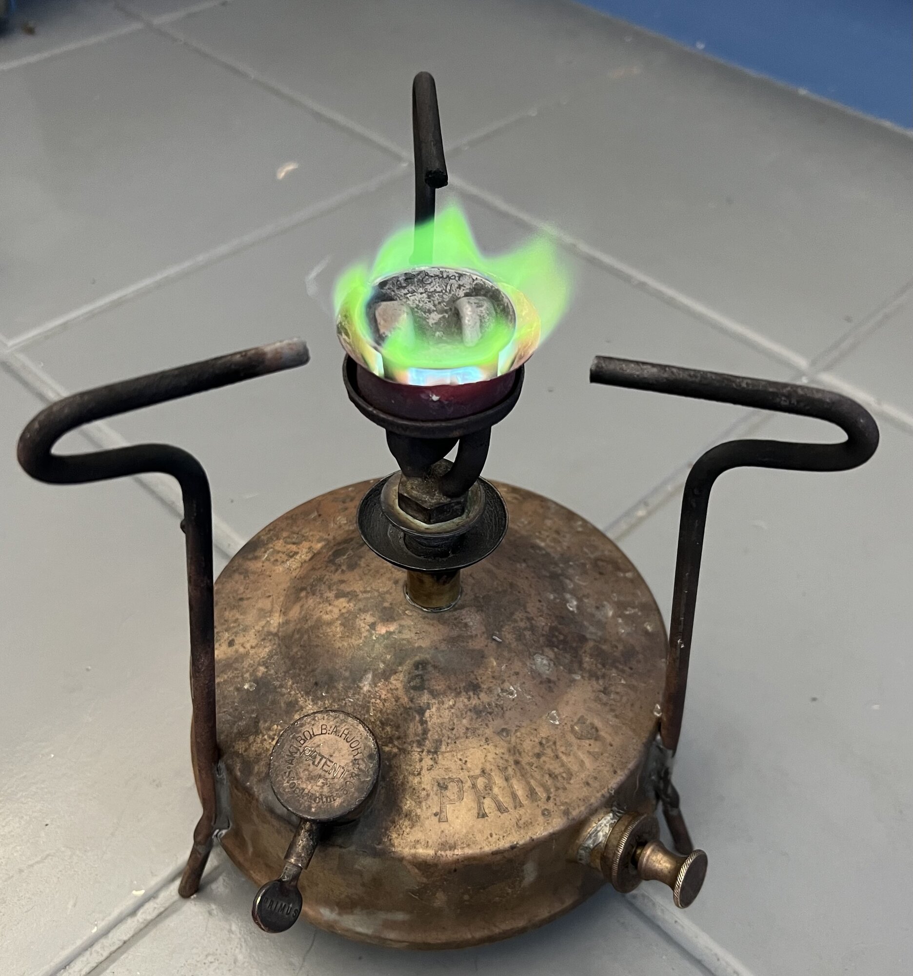

    Uh Oh! A faint puff of smoke at 1100
    Applied the lighter and
    It is still roaring well despite the small leak
    Another brazing job on the way.
    Thanks!

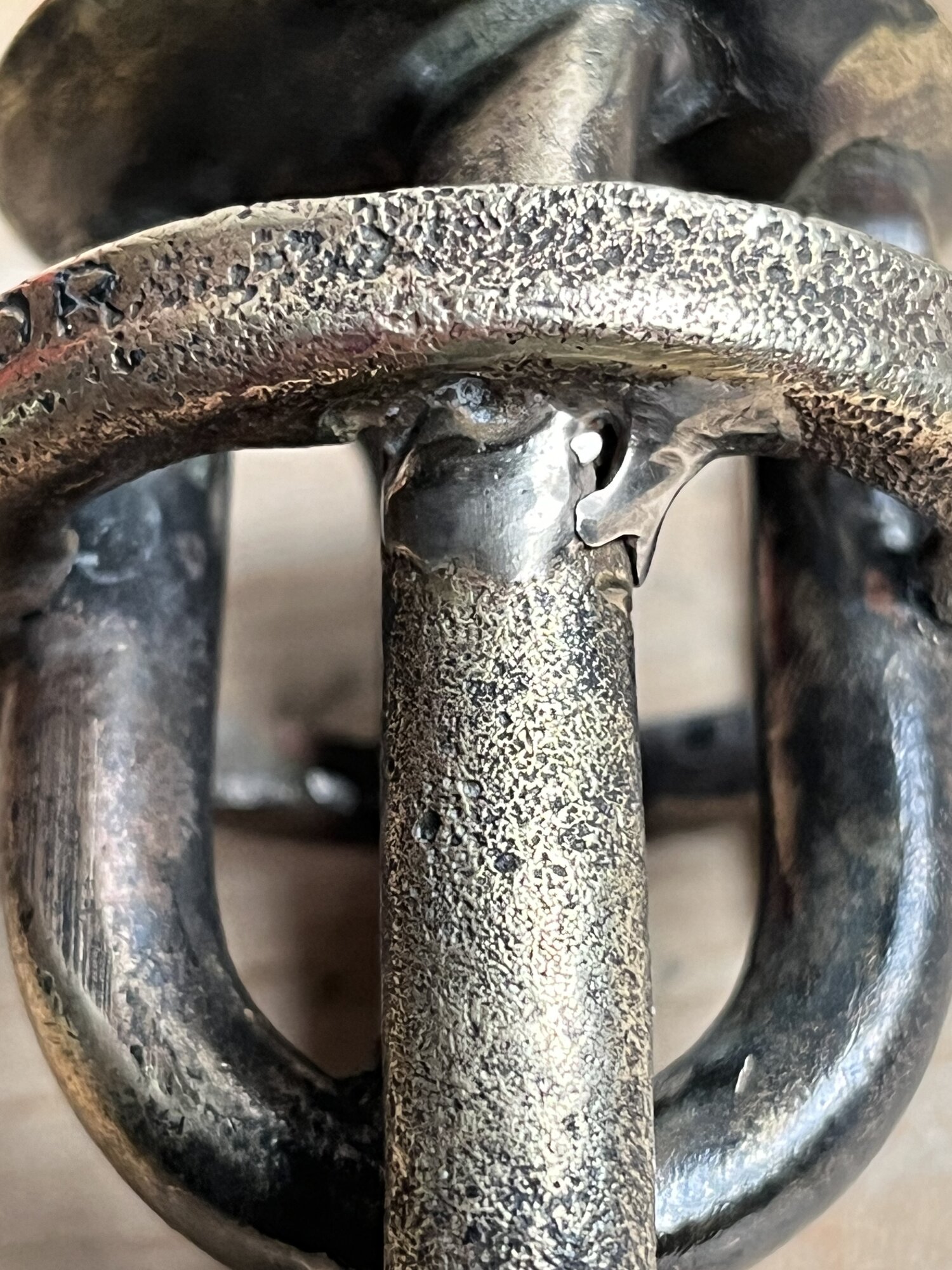

    @Rodger Willows and I spent some time recently working on this burner (and a few others).
    I silver-soldered a repair to the leaking tube, and we gave it a bit of a clean:
    It’s working very well now.
