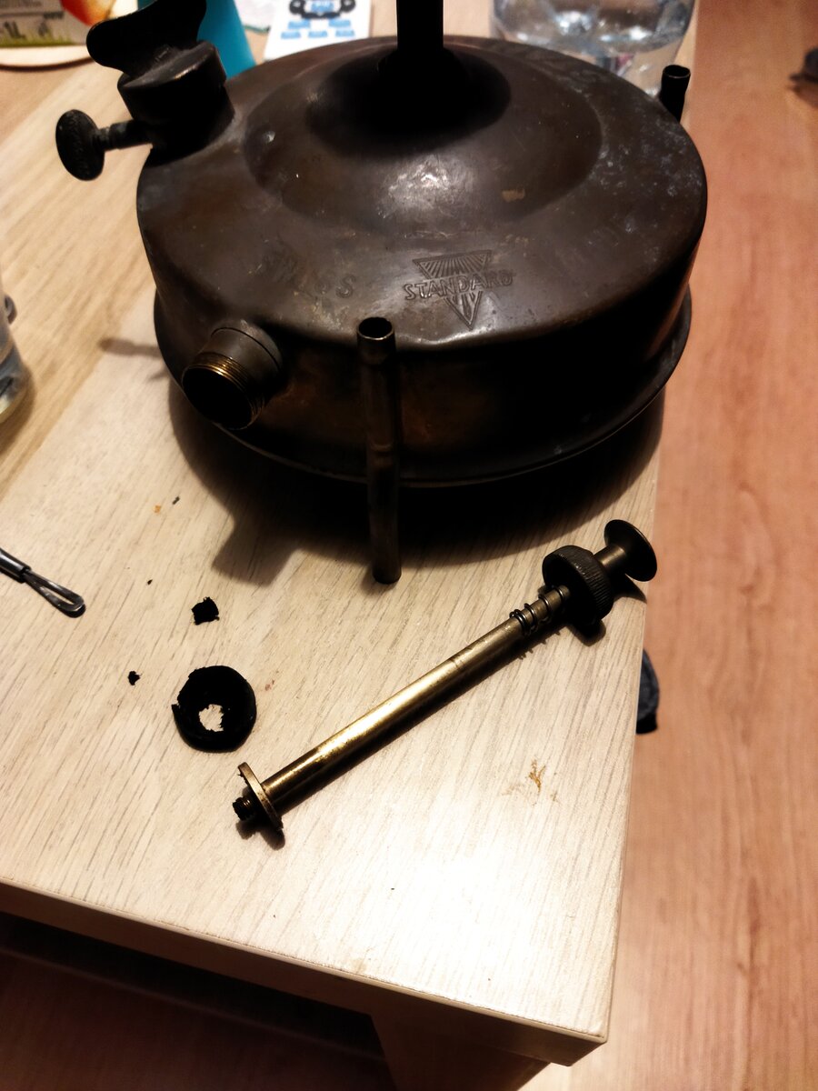

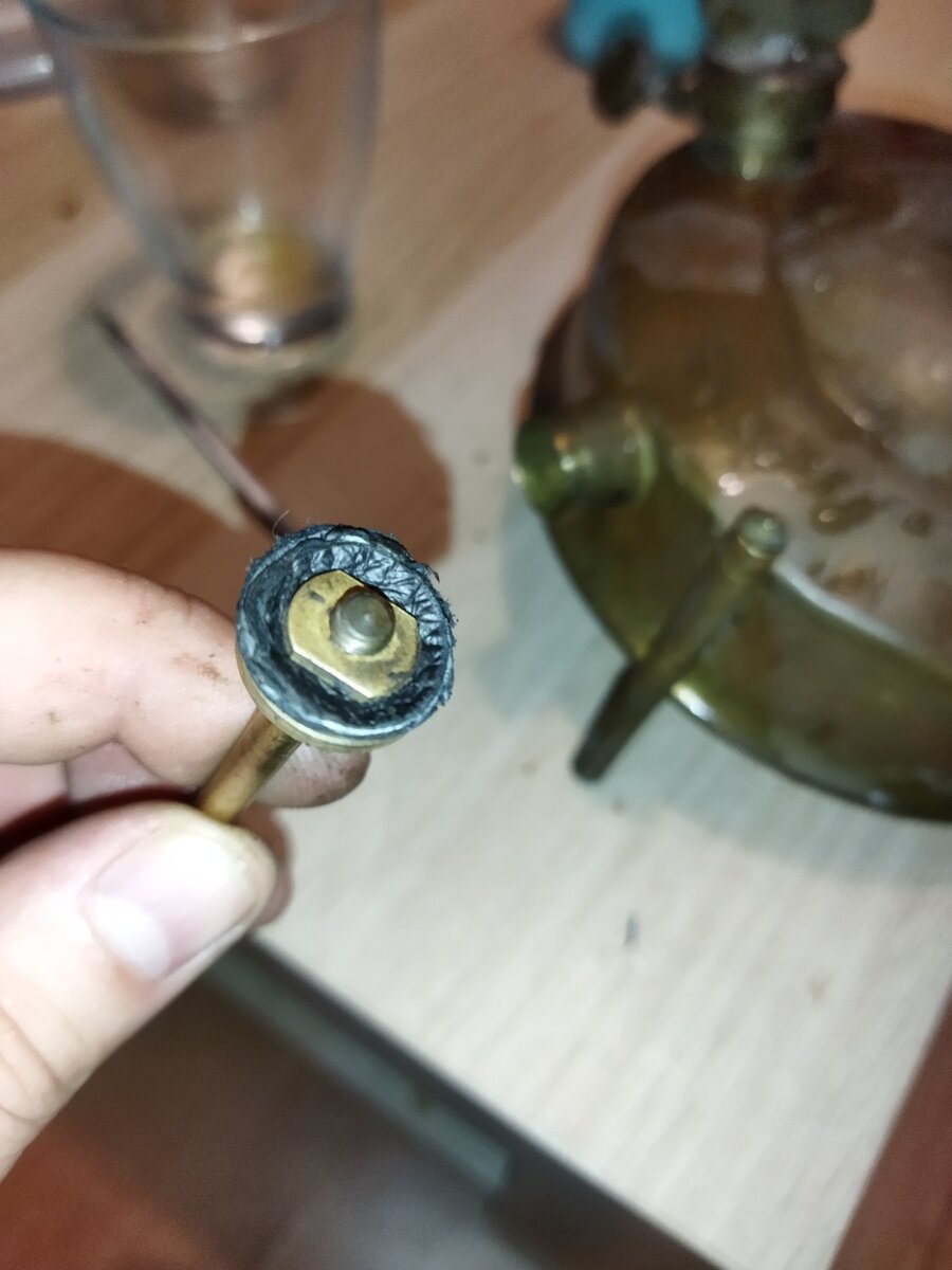

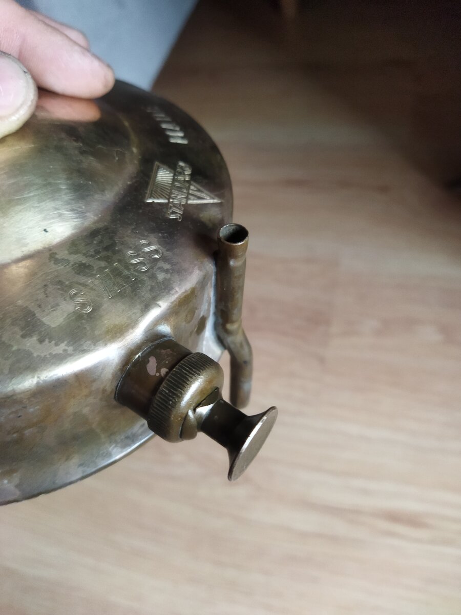

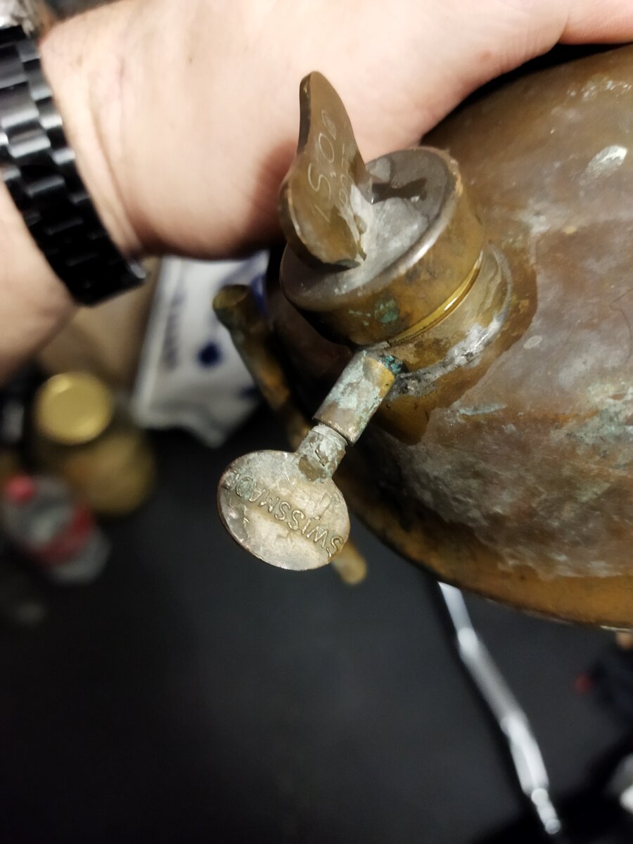

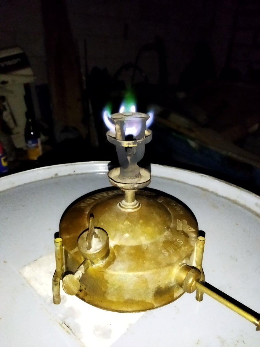

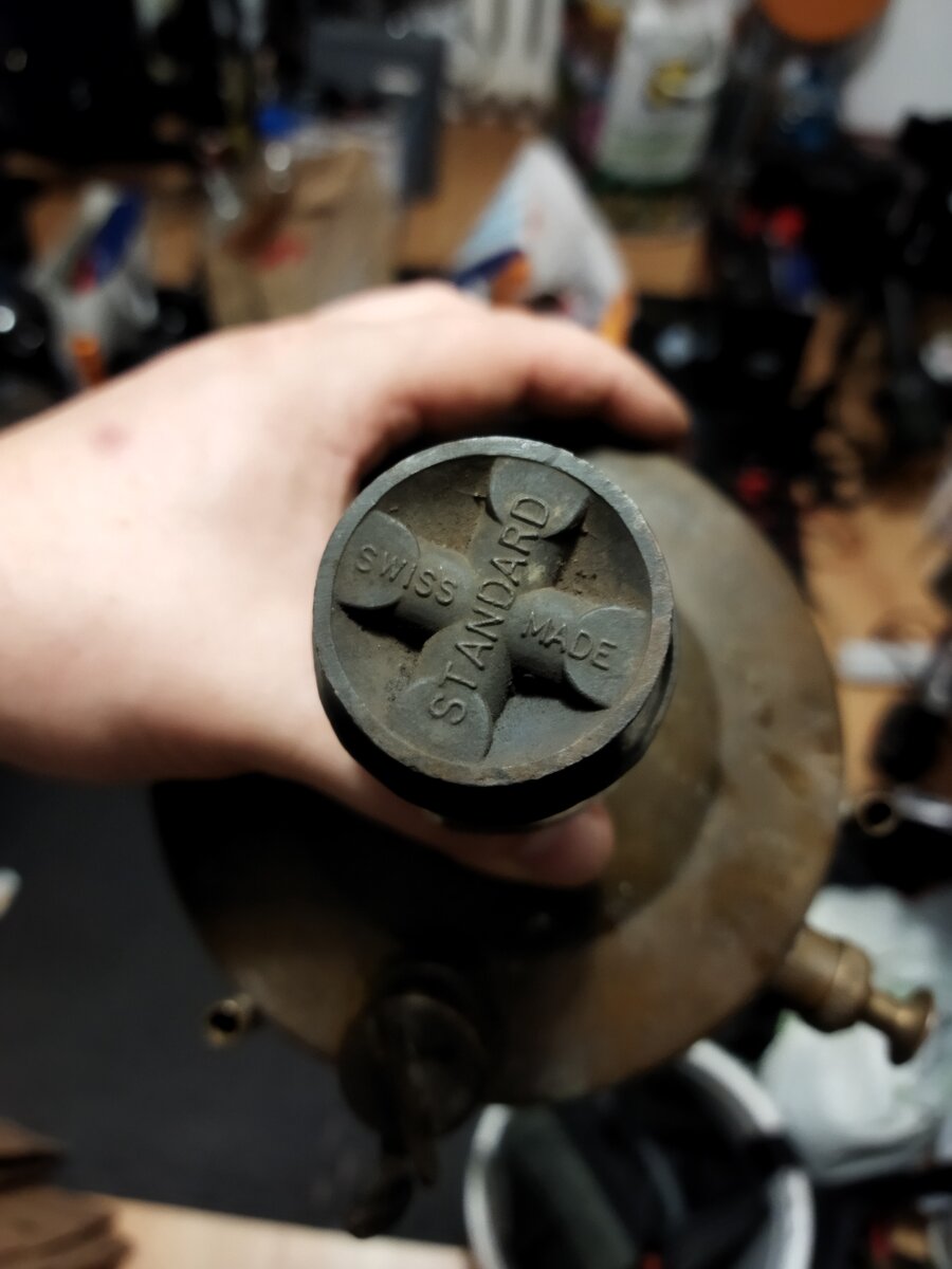

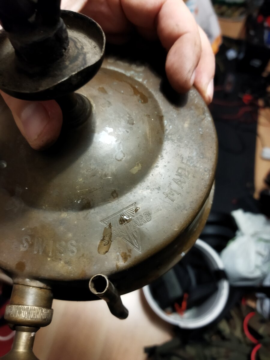

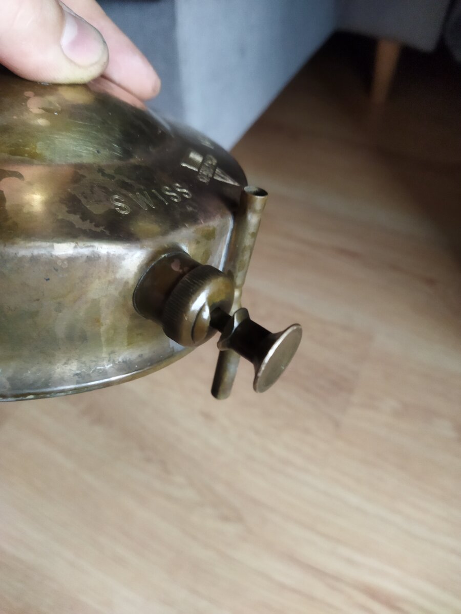

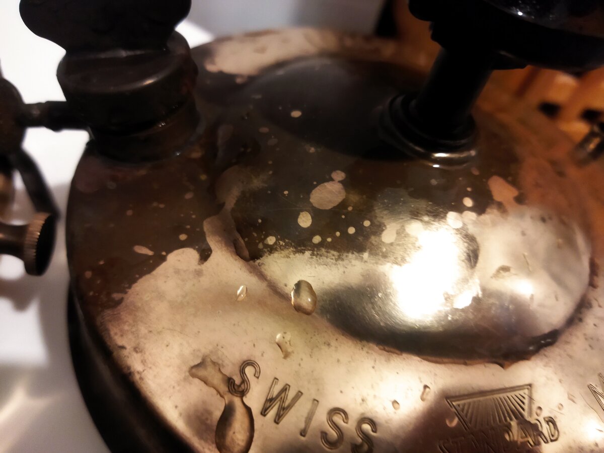

    Hello. In Poland, I bought such a beautiful burner for my father. unfortunately I can't find anything about it ... After replacing the leather seal, I was able to start it.

    Welcome to CCS, and thank you for your post.
    Your stove is missing a flame ring, and may require a new seal for the filler cap.
    Best regards

    WELCOME the Standard brand was made in Germany I believe
  4. Firestarter
    Firestarter United Kingdom Subscriber
    Jun 22, 2019
    303
    Plymstock Devon United Kingdom
    It does say SWISS MADE on the tank @CW

  9. Tomek Poland
    Nov 3, 2022
    25
    Poland
    Well that's an interesting story. So the "fly-by-night" company produced a burner with a German logo but with a Swiss address?
    Surprisingly, the seal holds the pressure very well.
    I will bend my missing legs, but I don't know yet where to get the flame ring. What year of production can it be? Best regards to enthusiasts
  10. Petroman
    Petroman Netherlands Subscriber
    Oct 10, 2021
    158
    Netherlands
    Hello,
    Why fake ?
    Standard was originally a swiss company. But Like AIDA taken over by Ehrich&Graetz.
    So both is correct: Made in Swiss and Made in Germany.
    never forget that Made in Germany worked better in sales back then (and maybe now still).
    New petromax lanterns are made in the far east but branded Made in Germany.
  11. Tony Press
    9,370
    You can get the flame ring from Fogas.se

    Mar 3, 2022
    1,305
    Poland

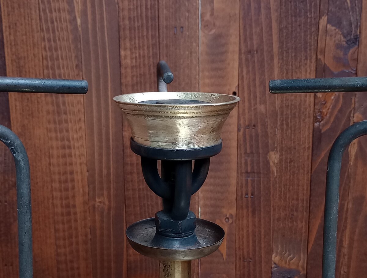

    Hi @Tomek.if it's an original cooker then cool. On the other hand, if it's a fake, that shouldn't bother you either (if you're not a sophisticated collector, of course).
    I have several cookers of 'suspect' origin in stock. (Some are very well made) and it gives me satisfaction to work on restoring them snd reinstatement to work.
    This, of course, is my subjective opinion.
    As for the flame ring, you can use the online shops recommended here, or have a good look around. Some items can be adapted for this (brass bells, lamp bases etc).
    I made this one by cutting off a piece of the bell. IMG_20220506_113145267~2.jpg
    Greetings
    Stanisław
  13. gieorgijewski
    gieorgijewski Subscriber
    Apr 19, 2013
    3,803
    It is moore complicated as we think...
    Shortly
    Stove imo is from 1930 to 1950
    If "other" examples do not have DRGM code
    AND
    Do not have "nur fur petrole"
    Made Germany could be only "product location" - produced i.e. in Silesia (like large part of Myszkow production)
    My first reaction was Warsaw fake.
    But it was stable quality production - with country change.
    30-50 was too many facts to easy recognise reason.

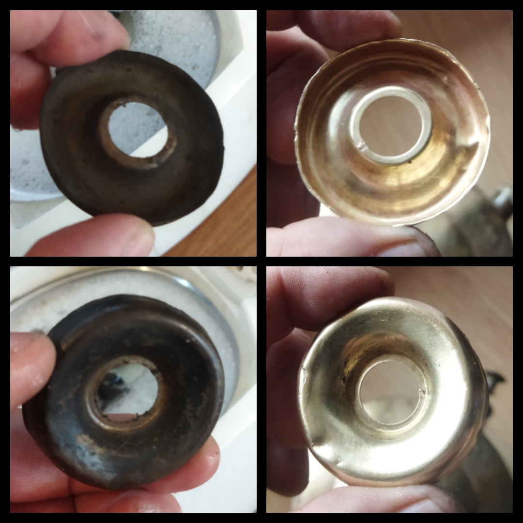

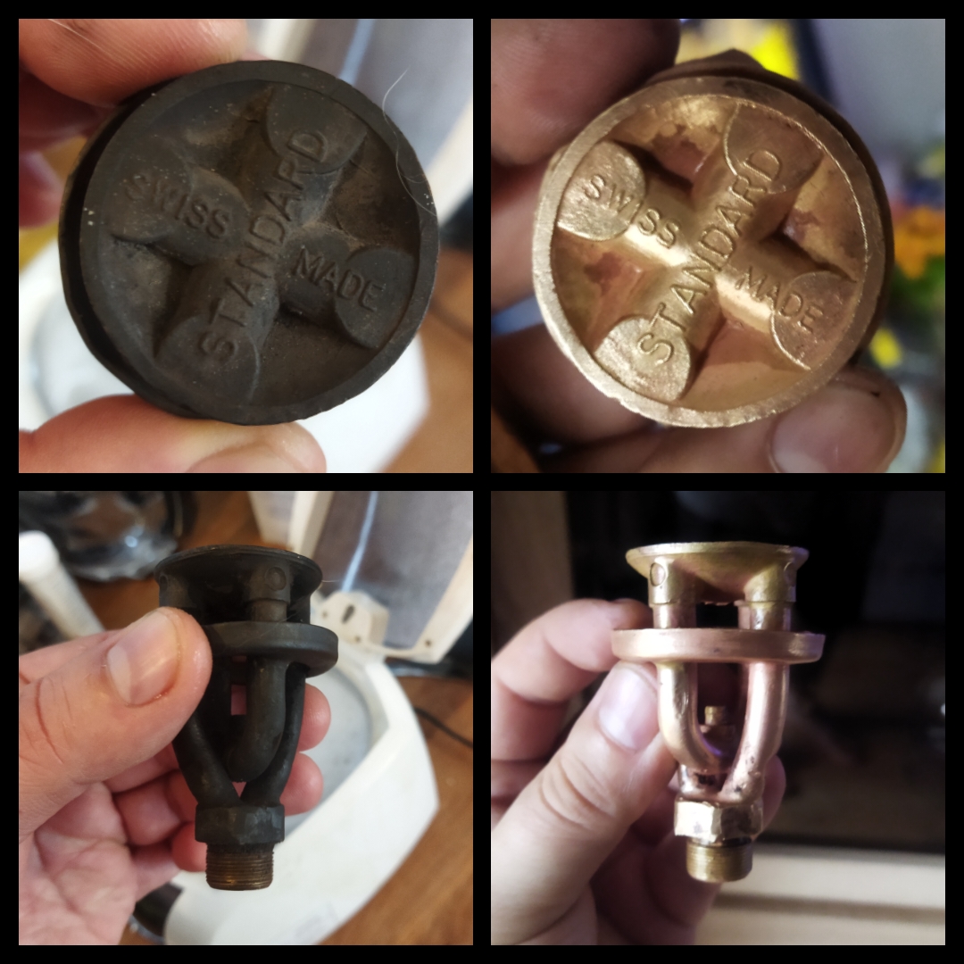

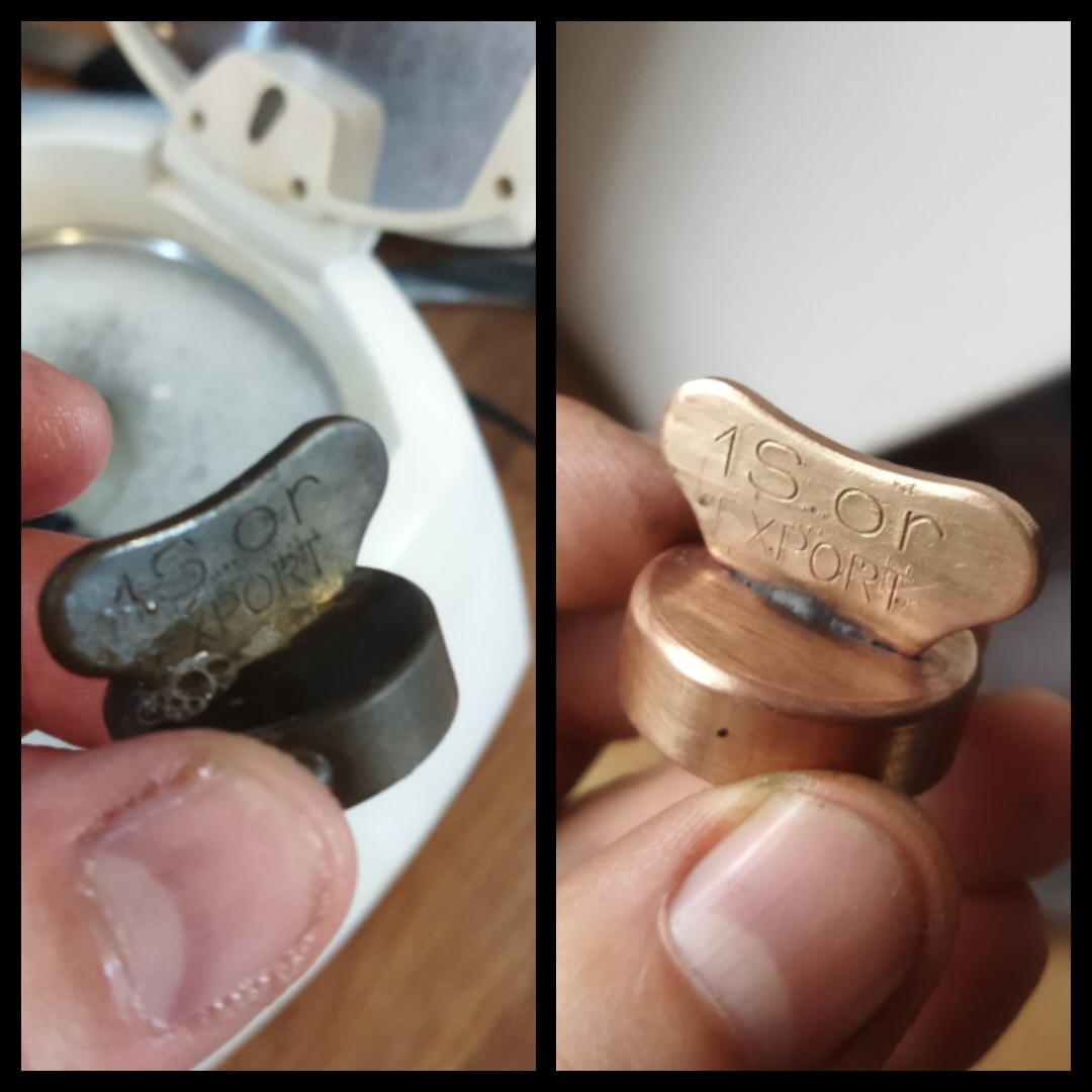

    H₂SO₄ and 000 steel wool give great results
