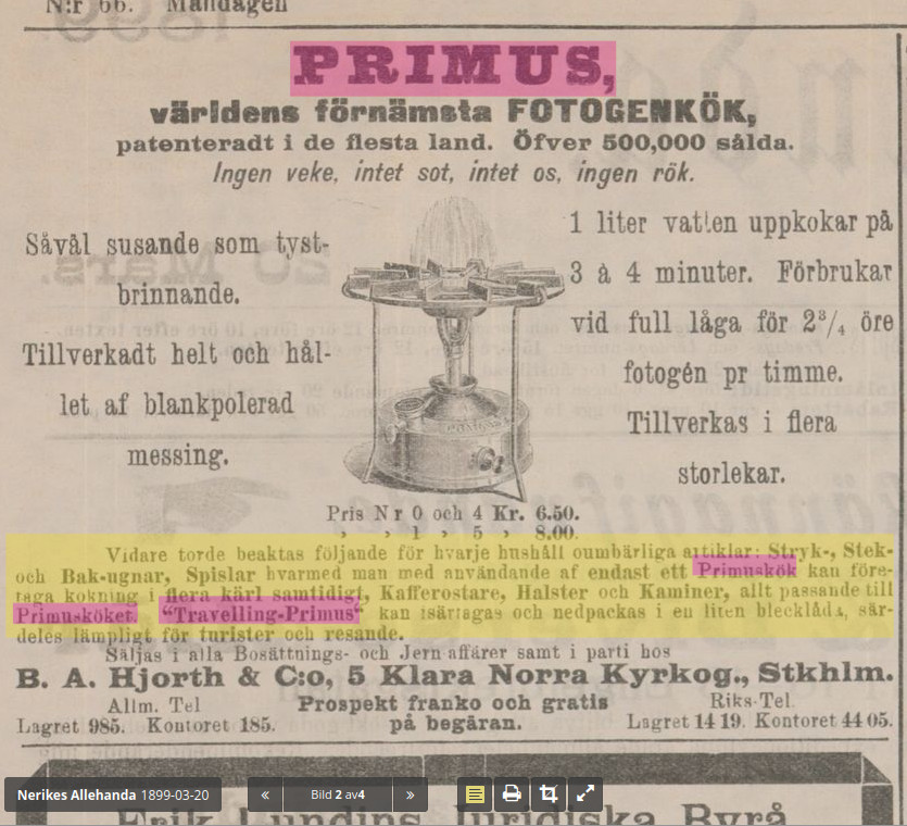

unfinished picture of B.A. Hjorth in 1892/1893 based on ads

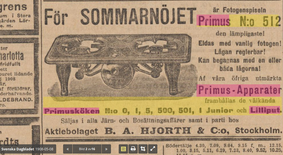

    its hard to solve thats
    initially i think We can dated by Bade shields
    but No
    the same shields with Hjorth was in use later
    especially in non popular low production stoves
    1915
    Primus No 96. Made in 1915. Code "E"

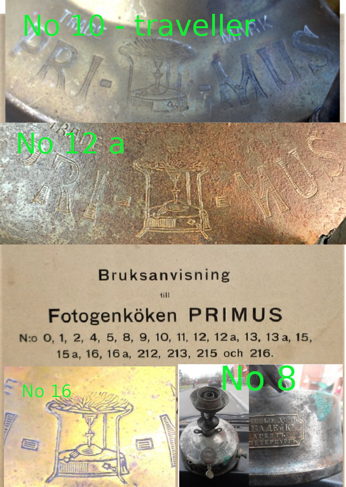

    That is a no. 8 with the wing nut burner, right? Ought to be from around the 1903 mark. Or, we could look at the first mention of the wing nut burner. Perhaps @Christer Carlsson knows what this is called in Swedish?

    But all 6 of these models do appear listed in a general operating instructions leaflet dated 1900 (here) .

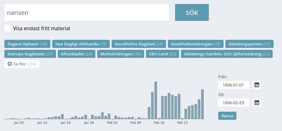

    Nansen episode in Hjorth work
    In timeline of Primus ads We can find connection with Nansen
    For the story subject very important is the date of this ads
    14 - 02 - 1896
    before from 23 - 01 - 1896
    "current" ads was
    as We see nothing special "We selling Aetna Vesuvius blowtorches and stove Primus"
    in Hjorth work just "CALM SILENT PEACE" - boring time

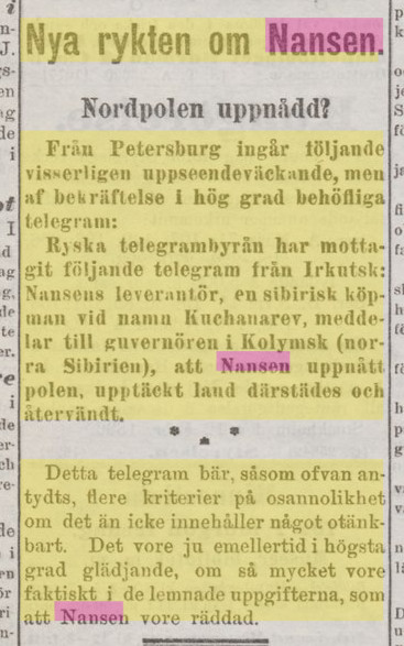

    In press 13 - 02 - 1896 was "exploded" news about Nansen
    Sök bland svenska dagstidningar
    initial information was telegram
    "from Irkutsk vie Petersburg - aroung Kolyma was Nansen"
    in 13 - 02 - 1896 that was main information of the day repeated in many newspapers in special editions too
    above was in 13 - 02
    above provoke Hjorth to action
    to the "old-current ads" added "new with Nansen" join to the "telegram Nansen" rush
    next day - "We have"
    this "act" - was part of information snow ball in the next days

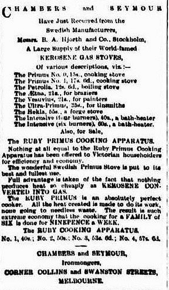

    resume of upper post
    - Hjorth needs to exists in newspapers - in active form
    - Time to reaction TTR of Hjorth in ads - is 1 day
    - to inform about "new stove" - do not need "new graphic" for ads - old type tank is used
    vs or AND gives date of numbers on P No 1 and P No 0
    - [​IMG]
    from the Melbourne 'Argus', 13th March 1896.
    Primus '0' 1894-5
    - numbered PRIMUSES ARE "ON THE WAY"
    Why vs or AND...
    This date could be explained by the "delivery time" in Australia , where in Sweden it was it was limited by "time to realise demand"
