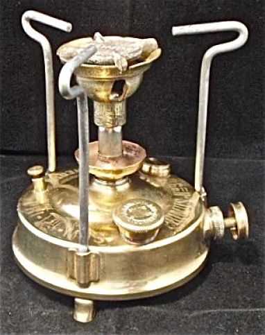

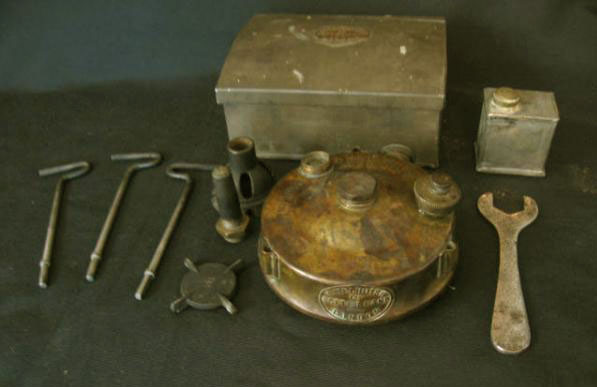

    Courtesy of Don (ebayer - red-eye1999)
    This auction was recently brought to Bryan Miller's attention & Don kindly agreed for the pics to appear on the site.
    I always thought from the evidence I'd seen that the 96 started in 1911 (I have ads from 1911 showing the 'new' outfit but had put the differences down to artistic license). I'd queried Bryan about a statement he'd made along the lines that the early airscrew's were on the filler caps before moving to the tank & then back to the filler cap around 1921 - the pictures of the stove featured here is what he produced to back up his claim.
    As you can see it also features collared legs, a feature found on a few other early Primus models. It also has a hexagonal storage boss. This is like that used on the later Optimus 96 & unlike later Primus bosses. I believe this is original as the early ad I have shows a hexagonal boss.

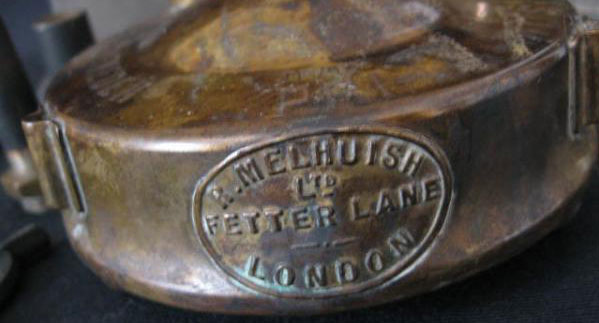

    The stove & tin also carries a soldered on brass plate bearing the name R.Melhuish Ltd, Fetter Lane, London. Melhuish were a large retailer & it is not uncommon to find several Primus models bearing this plate.
    All in all, a fantastic find - maybe the buyer is a member here?
    1223321652-001.jpg 1223321670-004.jpg 1223321676-005.jpg 1223321728-006.jpg 1223321738-007.jpg 1223321665-003.jpg 1223321745-008.jpg 1223321659-002.jpg
    The ad shows the same style spirit can as well as the hexagonal storage boss & the pressure release on the filler cap. The artist has omitted to put the feet in the right place & there are no collars shown on the legs - likely artistic license?
    The ad is from the Civil Service CO-OP Society catalogue of 1911.

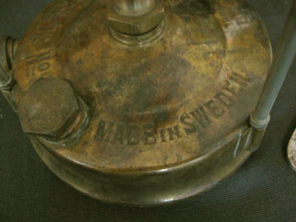

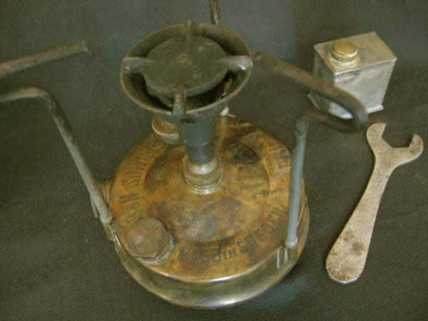

  2. Takeshi
    Jul 21, 2006
    59
    This model belongs to my stove mate and brrowed for fettlin by my way of.
    If this one is mine,I would say this 96 is coded A model.The engrave is quite sharrow and hardly hard to see,so foxy.
    So,I beliave bun foot 96 is made around within only one year too.
    I have 2 of A coded 96 and there are 2 type at pump knob.
    Earlyer has flat pump knub and later one is same as this image.
    maybe some of collapsible pre 1911 models has flat knub(for example I have non-dated230 bun-foot,collared legs with flat pump knub),so I would say this 96 is shallow engraved A model not pre 1911.
    About conditions.
    This rebadged model could be said 10 out of 10.
    regards TS

    Thanks Takeshi - would you be able to get a better picture of the date stamp please?

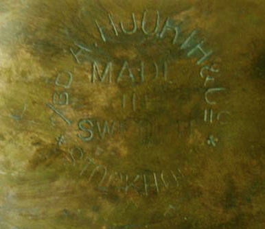

  6. Takeshi
    Jul 21, 2006
    59
    Hi Ross,
    Here goes.
    Maybe better,my digicam's best close up but still hard to tell how they are.
    regards TS
  7. Spiritburner
    11,667
    I'm afraid I still don't see it?
  8. shagratork
    9,633
    I'm with you, Ross.
    I can only see, "MADE IN SWEDEN".

  10. Takeshi
    Jul 21, 2006
    59
    Hi Bryan,
    sorry about late reply,haven't check recently.
    I can say it is coded A just sharrow one,but hard to tell others.If this bun feet 96 is pre 1911 it should be slight different parts design at pump knob and lid.So am not agree with your opinion about.
    Here is another info just I noticed about stamp pattern how they should be.
    There are 2 quite different character between pre 1911 and post 1911.
    I've checked 5 different pre 1911 models and 5 of 1911=A,some of them are furnace and blowlampe include.
    beggining 1911 until early 20's I belive Primus use the same diagonal dimension stamp,only they change the code like A to K.
    I took pics,so check them how different.
    pre 1911 models 2 of No:1,No:5,banfeet230,company model furnace
    1262173052-pre_p5.JPG 1262173010-pre_p1.JPG 1262173120-pre_furnace.JPG 1262173072-pre_p230bunfeet.JPG 1262173032-pre_p1_.JPG
    1911 models are 2 of usual 230,2 of bunfeet 96,aetna blowlamp
    1262173618-post_aetnatorch.JPG 1262173494-post_230_2.JPG 1262173472-post_230_1.JPG 1262173410-post_96bunfeet_normal.JPG 1262173389-post_96bunfeet_flat.JPG
    This one I posted before has typical later version,so I guess enough to belive it was stamped A just hard to see one.
    Collectors,if you have not as these pattern please post your images.am interested in irregular.
    about Trevor's 96,does it 2nd design feet but without code? am doubtfull that,so I want to see it pics very much.
    regards Takeshi

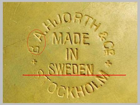

    Takeshi - it may be helpful for others to see your picture of the V1 Primus date stamp with your red marks highlighting what the camera can not capture. It certainly was a big help for me. If you are in agreement could you post it here please/

  20. Takeshi
    Jul 21, 2006
    59
    Happy New Year gents :)
    Now 2010 in JPN time zone.
    I haven'r seen Gary's stamp before,it's new to me,interesting!thank you ;)
    I guess it slight earlier than I posted pre 1911,isn't it?
    Ross,sorry I don't have V1=1931 model :(
    Hi,Bryan
    at first.thank you about images.
    I think the burner plate and tank lid are correct to 1911 model.
    The burner head seems to me later 20's pattern.The burner tube is bit hard to tell the correct age to me but is likely later one,asa far as I know early 10's tube has tend to no stamping on the hex lid side wall.
    The early burner tube is straght out to the end of hexa lid,so you can see it double wall the thread tip,does yours too?
    The second generation tube stuck inside the middle of hexa,so easy to judge,also the kink of top head is different early has angular than later.
    Parking boss seems to me second generation,pump assembly also.The pump assembly C to E?I didn't own 96-1912 so I can't include B.
    The reserve lid is not early 96's I think,both of mine has no thread inside.
    about 96-1911 burner head,it is slight different than later 10's.It is bit thinner and air hole vent has sharpen kink,I checked 3 of and all tend to this way.I don't have the best sentence to explain.I don't like to use language auto transfer but hope you understand or imagine what I want to saying :-k
    sure I will post images. I have to clean them first,will do until spring I promise :p
